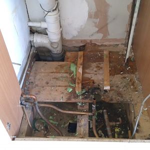

  9. A
    Basin drain relocation garage conversion
    The wc pan i believe is clay, how would you recommend I remove this without damaging the clay pipe below? I also would prefer to move the pan closer to the wall, rather than how it is currently, will this be easy to do or involve a lot of digging? Pic attached...
