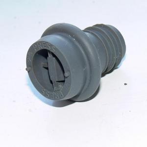

    sink and dishwasher not draining (hi-jack split)
    Thanks JohnD. I suppose it's obvious really, but until I had the blocked sink outlet I didn't think about the dishwasher outlet pipe being looped up. Anyway, pipe looped up, sink unblocked and dishy working! Many thanks for the help, Tony
  9. B
    Thanks for the responses. I didn't even know we had one of these things! I do have a partially blocked drain, but also it looks like the non-return valve in the dishwasher (Bosch Classixx) is not working i.e. If I fill the sink with water and then pull plug out, the water from the sink goes...
  10. B
    This morning my sink did not drain properly. At the same time my dishwasher (whose outlet pipe is attached to the U-bend of the sink) failed to drain properly - 2 or 3 inches of mucky water in the bottom. I have rodded the outlet pipes from the sink so this is now draining better (still not...

  13. dishwasher
    dishwasher
    is this a non-return valve from a bosch classixx?
