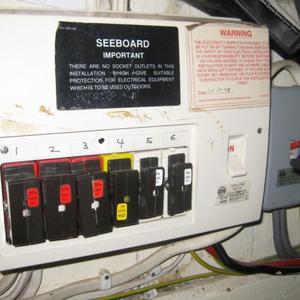

    Thanks. Do I need to replace the whole board or is there way of taking a feed off the single unsed way in to a "mini RCD", Just seeking the cheapest solution, Thanks

    Hi Photo attached. Its a 6-way, I have at least 1 unused way. Its got a installation sticker dated 1993, I dont imagine its been looked at since then. No alteration have been done on the electrical installation and on that basis I would say I believe the bonding and Earthing up to...

    OK thanks I will speak to the electrician. However I was kindof hoping someone on the forum could answer my first question, i.e. is it permitted to run a new circuit in to my old CU with it's old style cartridge fuses? Or do I need a 17th Edition CU. Maybe electricans read this forum or...

    Hi ericmark Thanks for the reply. I have some questions if thats OK. Q5. Are you saying that the CU will or will not need to be updated? I would like to avoid a CU upgrade if this is possible/permitted? Q6. Are you saying that if I do upgrade the CU I can use Hi-tuf but if I don't...
