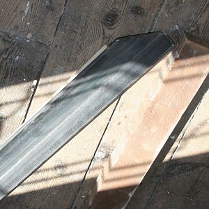

    Not remotely easily, no. The floorboards are the original victorian ones. They are T&Ged with metal strips. Taking up floorboards without much destruction then becomes a nightmare. I know I just did some. What I can tell you is that eight inches below the floorboards, (two inches below...
