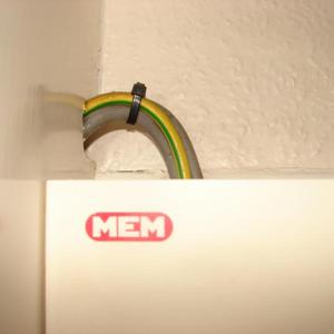

    What Earth is this if any
    I didnt think using the utilities pipes for earth was acceptable ? There is one piece of the ground floor that i noticed was suspended floor boards, the rest appears to be solid. Thanks for the help
  2. S
    Agreed on the Ze, did a Zs as i had a few mins. No RCD anywhere as confirmed by the Zs set on high and no trip occurred anywhere, unless the RCD is shot too. No Rod. Ive got pictures both front and back of building nothing to be seen I wanted to check what others thought as i lossed a bit...
  3. S
    Yes both are inside the fuse box
  4. S
    Can someone tell me what type of earth is this if any! The supply comes in from overhead poles. Into the left side of the main fuse Next to the meter is the first fuse box and a couple of earth cables go into the junction box at the top As far as i can tell one comes out the fuse...
