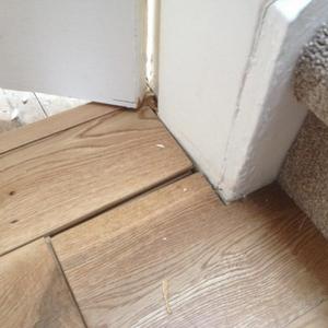

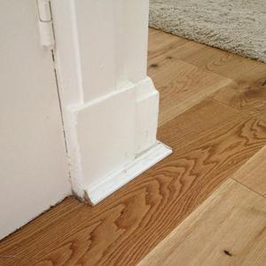

    Expansion problem with solid oak flooring
    I think that we paid cash to him on the day that he fitted it.
  9. G
    The floor is laid over a suspended wooden floor and as far as I'm aware, is blind nailed. The reason that it has started to split is that one side has filled the expansion gap and is now jammed against the architrave. The other side still had some way to go so continued to expand and then came...
  10. G
    Thanks for your replies. I'm not sure how big the expansion gap was in front of the door but its now nothing. It was filled with what looked like mastic. You can just make it out in the third picture where its been compressed against the architrave. I can't see the expansion gap around the...
  11. G
    Back in October I had a solid wood floor fitted in the hall. Three weeks ago, when the weather warmed up, I noticed that the transition into a bedroom at the back had begun to develop gaps. When I thought about it further, I realised that the front door had become more difficult to...
