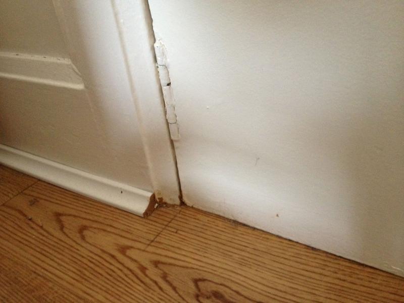

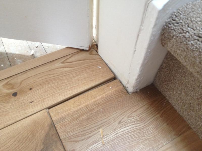

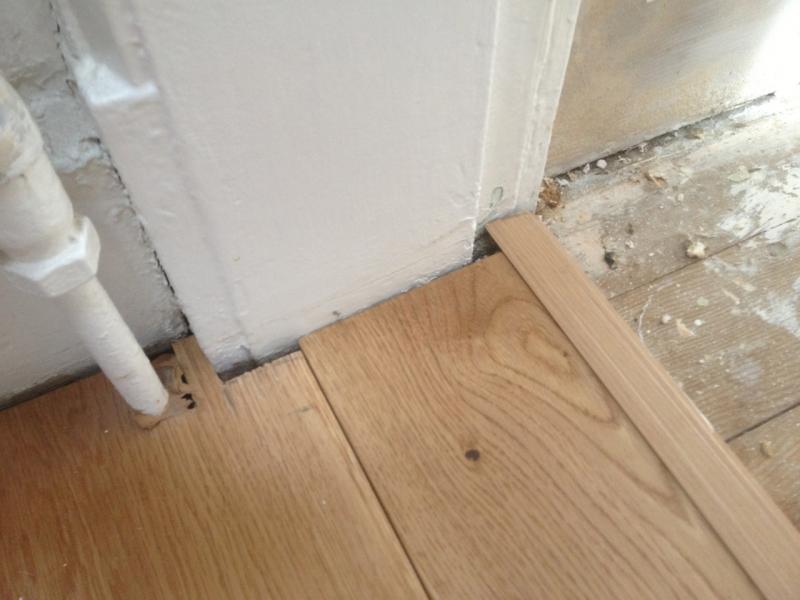

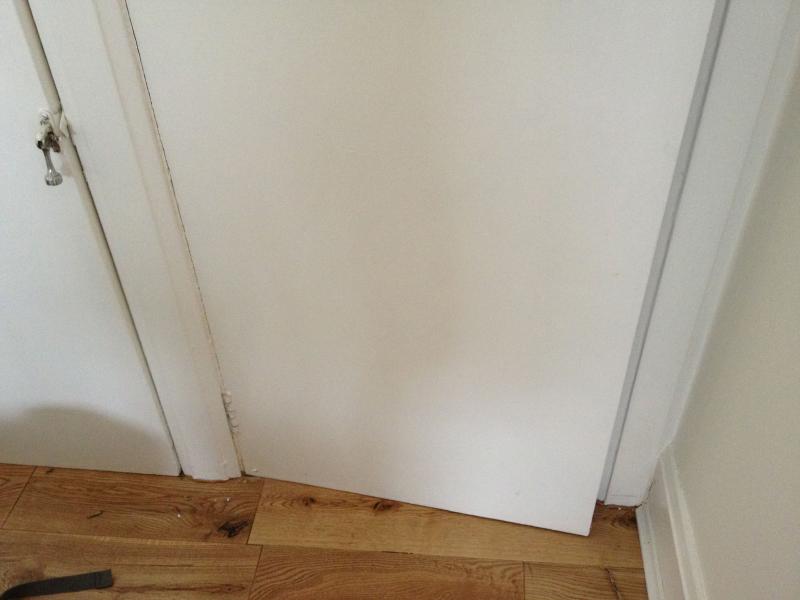

Back in October I had a solid wood floor fitted in the hall. Three weeks ago, when the weather warmed up, I noticed that the transition into a bedroom at the back had begun to develop gaps.

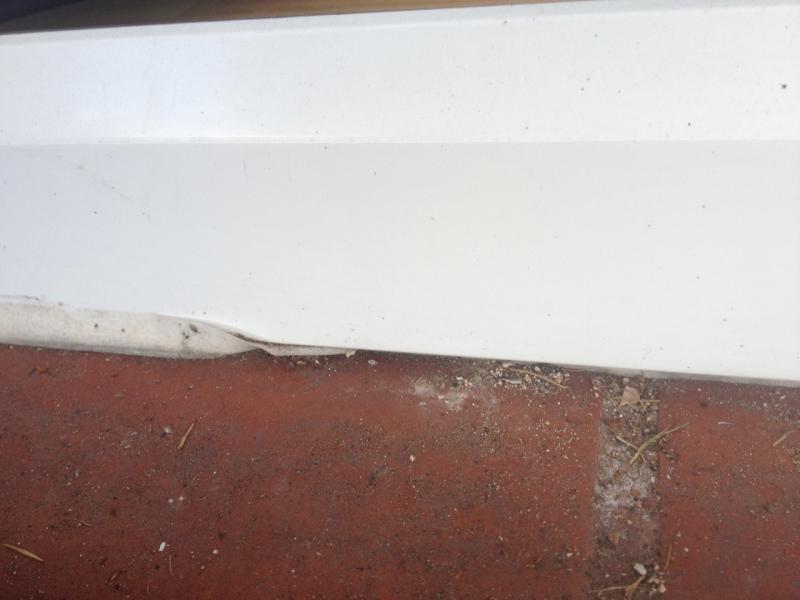

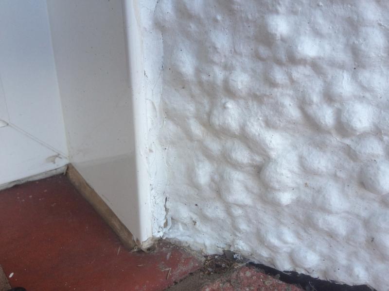

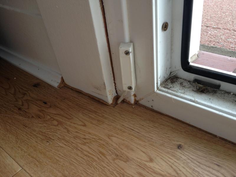

When I thought about it further, I realised that the front door had become more difficult to open and shut, and on investigating, discovered that the expansion gap had closed to nothing and the floor was clearly now pushing on the front door. This has damaged the architrave and caused the UPVC panels on the front to push outwards and the door frame has pushed over the top of the sealant.

How much expansion gap was there originally? Should have been at least 10mm gap, but could be more with solid wood flooring.
The "fitter" should have undercut the doorframe, so the wood could slide underneath.

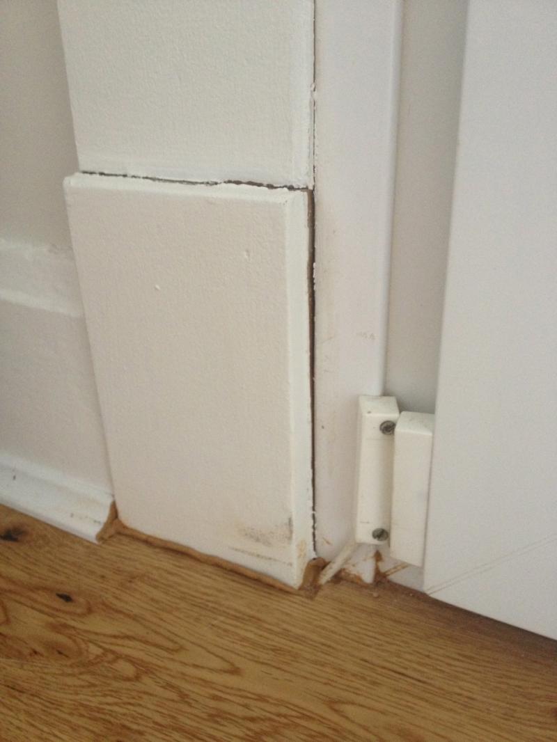

Thanks for your replies. I'm not sure how big the expansion gap was in front of the door but its now nothing. It was filled with what looked like mastic. You can just make it out in the third picture where its been compressed against the architrave. I can't see the expansion gap around the rest of the floor as its covered with scotia beading.

The quality of the fitting does'nt appear to be too good in the pictures, as has been said, the architraves should have been undercut, and mastic should'nt be used to fill gaps etc.
Having said that, it's not a great idea to 'float' a solid floor either, they should be fixed to the subfloor either fully stuck or secret nailed with the appropriate subfloor preperation. The retailer should have discussed this with you before any order was placed.
Clearly the floor is moving, and it would be useful to know why, despite the obvious issue, something like a leaking radiator etc could be the cause, and that's likely not the responsibility of the flooring company or the contractor.
To investigate further, you'll need to remove the scotia, but ideally, go to the retailer and insist that they inspect it. They may realise the issue quite quickly upon inspection, for example they may be disapointed in the quality of the fitting etc that they just won't be expecting.

The floor is laid over a suspended wooden floor and as far as I'm aware, is blind nailed. The reason that it has started to split is that one side has filled the expansion gap and is now jammed against the architrave. The other side still had some way to go so continued to expand and then came away from the board behind it as it was jammed on one side. There was a slight leak from the radiator next to this before Christmas, but this has only happened in the last month so I would be surprised if the two are linked.
How should he have hidden the expansion gap in front of the UPVC door? I can see cutting underneath the architraves to hide it here, but he clearly can't do that with the door.

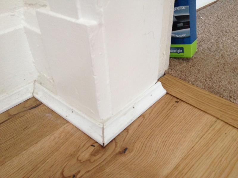

What's evident here is bad fitting mitred external corners, those corners are as bad as I've seen (well that's not exactly true) but bad enough. Were they as open as this when fitted? OK wood can shrink but not lengthwise which is what is displayed here. So if that's how the finished trim has been done I hate to think what the rest is like...pinenot :)
