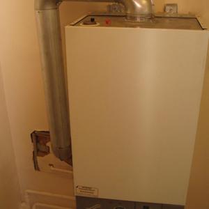

Here you've got 2 concentric flues joined together by some metallic flue liner. Notice the dots on the lower flue? Those are holes drilled into the flue to allow a bit more ventilation in to the loft!!! The whole lot was condemned and ripped out. (Photo taken by Gary). Goes to show you that if...
I wonder if the lower window would act like an inverted guillotine!. I'm certain this would need a flue guard which would scupper the whole installation.
How was this done?. Who did the glass cutting?. Then you get to the interesting bit. Is it legal? The flue terminal is more than 300mm from an openable window or vent!.
