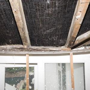

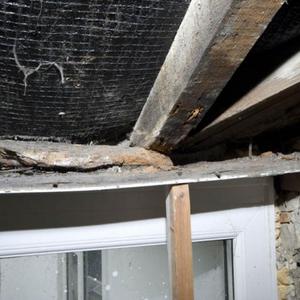

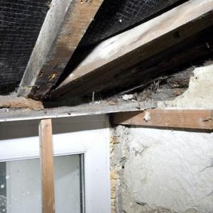

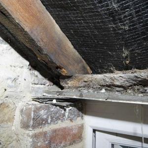

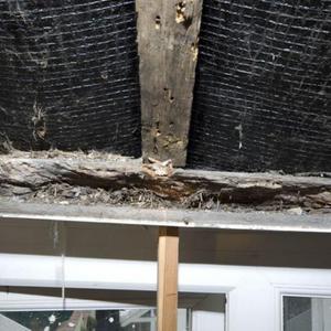

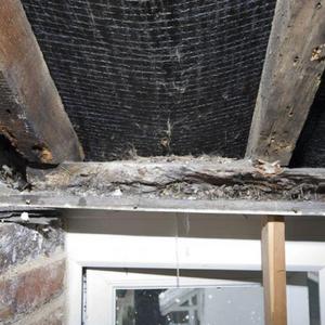

    Roof above bathroom window
    I can't thank you guys enough for the advice. Just to let you know the bathroom roof is now safe and secure as I used a bit of most of the posts here. The hole outside is covered with brick and mortar now and the new wood (treated) is in place with some angle iron. I had to strengthen a couple...
  9. P
    Thanks for the advice. Yes the uPVC windows are not the best option, but they were already installed when I bought the place. They were put in pretty poorly and have caused so many problems. The whole place needed the plastered walls sorting out and so much of the wood had been left...
  10. P
    Hello This is my first time posting on here, although in the past I have seen some good advice. I have an cottage (circa 1840s), which has had quite a bit of playing around done to it over the last 60 years or so (most of it bad). I'm not working through trying to fix the bad stuff and...
