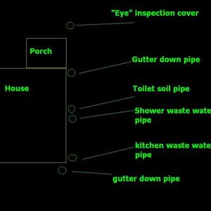

    Blocked Drain SOS!!
    Fixed it!! well, after the rod snapped, i thought "what the hell" im goign to have to dig it out so i dug down the shaft of the inspection cover, where i found the pipe was oozing water an god knows what else i uncovered the whole pipe an found the inspection cover pipe was just sitting...

    Blocked Drain SOS!!
    the drain is a clay looking pipe im guessing that is the slat glazed stuff i have a feeling there is a break somewhere in the pipe though as where i was digging out was absolutely drenched/ soggy down there so it might be a blessing that i had to dig it up (trying to find a positive in all...

    Blocked Drain SOS!!
    it was definitely an Oh "&*(??!! moment i was rodding away when the rods felt odd, so i tried to retrieve them, i got some back plus the brass collar of the one that snapped i have a feeling it has snapped passed the bend in the drain too, i will try an put another rod down with a slip...

    Blocked Drain SOS!!
    Thanks for the help guys please excuse my dodgy ms paint skills i tried to rod the "inspection covered hole" last night an ended up snapping the drain rods, leaving 3 or 4 rods still down there. god knows how they snapped - possibly just cheap an nasty SilverLine from toolstation...

    Blocked Drain SOS!!
    right im off to try an find a man hole cover the inspection cover in the garden is covering a pipe that i have already rodded, but i didnt feel like the rod hit anything etc an the full length of the rod went down i have already had my hand down each of the gullies an emptied a bucket...

    Blocked Drain SOS!!
    Cheers burnerman! sorry to sound stupid but how would i rod downstream? would that be through the inspection cover in the front garden - its only about 5" wide something i shoudl have mentioned before, we also have a down pipe off the gutter on the rear of the house, i took this pipe...
