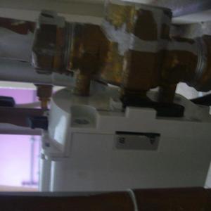

    Removing a diverter valve casing
    Thankyou Agile i have been looking around the valve and still cant see any where to open it up so i will disconnect the mains and give it a gentle pull to see if it will lift up. Can anyone also tell me if the cold water inlet pipe to the hot water cylinder ever get warm/hot as lately when i...
    What it is, you see is that if i give the diverter valve head a gentle tap it then starts to open the valve to allow the hot water through to heat up the cylinder. after about a day the water starts to cool and then we give it a gentle tap and it opens up again. What i wanted to check by taking...

    Hi does anyone know how to remove the casing on a 2 port diverter valve its a range make and is white. But looking at it i cannot see any screws to undo to take it off so any ideas would be great many thanks. And yes i will disconnect it from the mains power supply. Darren

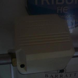

    As you can see the white box with the red cog wheel is not a cylinder stat as that is in a seperate pic. the last pic on the right is the zone valve actuator on the side showing the letters A and B. I will need to get a voltage indicator to check that power is getting to the zone valve actuator...

    vone valve from side

    front view of zone valve
  16. zone valve
    zone valve

    if the motor had gone in the actuator would it still move to the letter B when the central heating is turned on? because it does. Cheers
