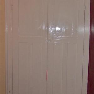

    Built-in wardrobe: ideas/trades?
    Hmm. That, and the pics from jasonb with MDF and/or MFC has given me another option. I'll see what the joiner says. I'm really not sure if I should be looking at pine, tulip, MDF or MFC. I've used MFC and MDF for bits and bobs in the past (boxing pipes etc.) but not thought of it for a...
  2. R
    Hmm, don't get me wrong: your example looks very good. But part of me liked retaining the original where possible, and I like the 1930s style. I'm happy that we have the original internal doors (1-over-3 panels), crockery cabinets, three fireplaces, front door, some windows, picture rails and...
  3. R
    Yeah, he said Tulip would be less knotty on the paint. I'm actually in the North East (Teesside) so I would have hoped it be cheaper! Anyway, the fella who was going to do a simple job with modern doors has come back with £650, so maybe £900ish for what we really really want isn't that bad.
  4. R
    Thanks. Funnily enough, we've just had another guy round who seems much more 'with it'. He said the same thing... bring out the existing, so they are both approx 60cm deep. He said it could be done with Pine, with or without backs (the current one is just a frame and door). Including...
  5. R
    Hi all, I've just moved to a 1928-built semi-detached house, which has a built-in wardrobes in the master bed. It is fitted between the internal wall and the chimney breast (with a cast-iron fireplace). The doors are 1930s-style 2-over-1 panel, and it fits into the skirting and picture...
