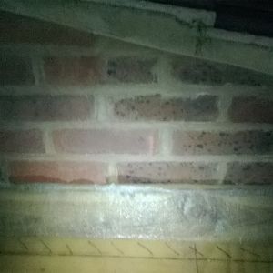

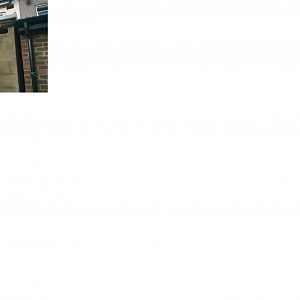

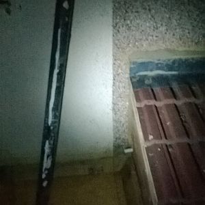

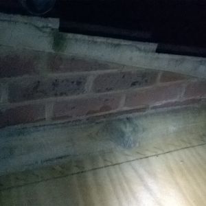

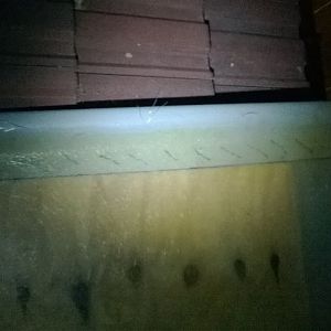

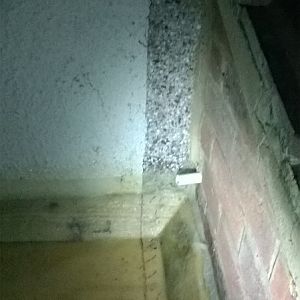

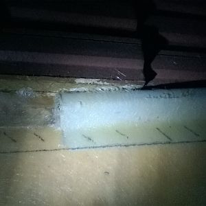

    So, must to bump this topic up again a bit. What are peoples thoughts please? Ask them to remove the 10cm of wooden roofing butted up to my property or leave alone and see what happens. TIA
  2. B
    Adjoining roofs between extensions. (pics added)
    I'm sorry they're not great pics. It's obviously dark now. Not sure exactly how the roof was constructed but it basically looks to be several layers of chipboard (ODB or similar?) covered in a fibre glass resin. Edit: rest of album here.

  13. B
    Nope. Not 100%. A not very clued up person at the council said that the developers hadn't notified building control and as such had been written to by the LABC with the case being passed on to planning enforcement. Don't know any more than that. Planning for a two storey side extension and...

  15. B
    Ah right! Thanks for explaining that for me. I'd assumed the trespass you mentioned was them doing the actual work. If the wood gets rotten/damp over time could it lead to the external brick wall of my extension soaking up water if it's permanently in contact with water? Though the extension is...
  16. B
    Yes. My concern is that if/when the roof leaks it will run down the side wall of my extension or at least the wood will become damp and soak through. I'm not concerned by the trespass side of the work. As I understand it builders are allowed reasonable access to my property to complete their...
  17. B
    We built a single storey extension with pitched roof on the rear of our terrace a couple of years ago. Our neighbours are building the same (albeit with a flat roof) and have left a gap of no more than 100mm between the extensions. They have extended the side of their flat roof over the...
