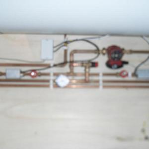

    Heat Banks
    I now have pics - more to prove I do exist than anything else. Clicky here I hope ---> http://www.diynot.com/network/gordonspants/albums/ Note these are during installation, so some of the wiring is a bit untidy and un-conduit'd, and everything is now insulated with armaflex, sticky foil...
