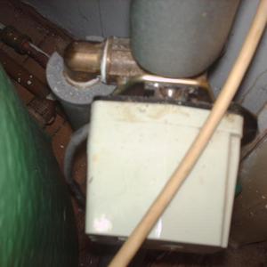

    central heating programmer sunvic select 207xl
    yes very old plumbing not been touched since house was built the pump is not fitted on a pipe like that it has a single pipe going in the bottom of it then going out the top, then into the actuator which then goes into an L shaped pipe above the actuator which branches of in 2 different...
