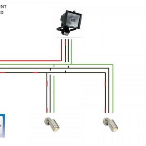

    Would it not be possible to wire it in the manner below? With the switch live from wired into the PIR load (output)? Don't take the actual wiring route shown as how it would be done, it's representative, I was considering a four core into the junctionon the left, Live > PIR LIVE...

    Hi guys, If your suggesting i wire the light fitting as shown below then the security light wont function when the switch is turned off, If i want the security light to work and leave the supply on that would mean the two spotlights are also on, I was considering whether it would be...

    If i was to go down that route though wouldn't that mean the spotlights would be on continuously in order to give the PIR a live feed which would kind of defeat the object of having lights only come on when activated by the PIR,

    Morning all, I have the current setup at the rear of the house, There are two spot lights on the left of the house turned on/off with a fused switch spur from inside, There are two spot lights on the right of the house turned on/off with a fused switch spur from inside, So two...
