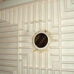

    Problems with leaking shower, any advice appreciated!
    Excellent! Just measured it and it's about 13.5cm (figured this'd be easier than inches) from board to floor. That's not an exact measurement as there's a piece of carpet (don't even ask, I don't know!) there, so maybe add another cm or so? The inside diameter of the tube is 7.5cm. I can't...
    Yeah, the whole thing's just stupid really. I'll try and explain in more detail how the whole thing fits together: There's a large hole in the tray. Into which is placed a tube with a lip. Under the lip there was, and should be, a rubber washer. This was then sealed with silicone sealant...
    OK, think I need to reitterate a few points: 1) The trap is new; it's what I bought from B&Q and what I put on. Before that it was just 1 pipe shoved onto the waste one end, elbow joint the other, no trap at all. The trap seen in the pics is fine and there's no leaking from the connection...
    OK, I have pointed to where I think the water's coming from. From underneath it seems to be running down the outside of the tube bit. From the top I think it's getting under the lip where I've indicated. Hope this helps! I find it confusing enough so I can see why it's not coming over as well as...
    Ok, here you go: As you can see from the pictures taken underneath the tray, the waste pipe and trap are not quite level. I've tried to level it by cutting a bit off the pipe that leads away from the trap, but it still ends up wonky. I've taken...
    Hello everyone, I'm hoping someone will be able to advise me on this. Several months ago the shower unit began to cause us some problems in that water was dripping into the kitchen directly below. I found a similar problem on this site and I followed the advice given; removed all the...
