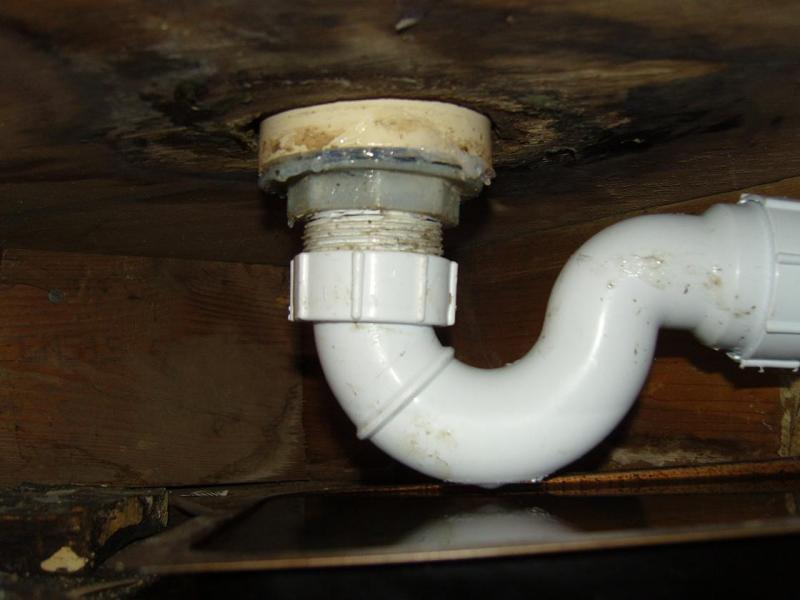

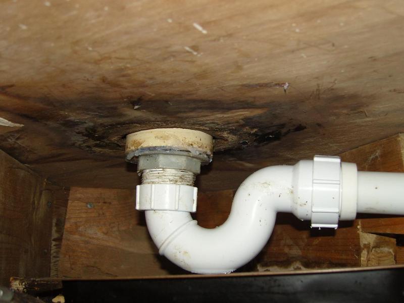

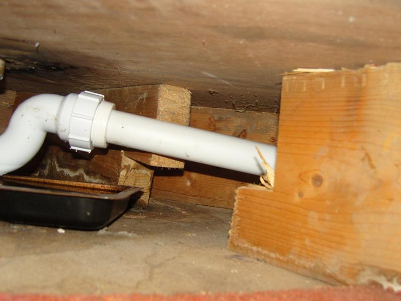

Ok, here you go:
As you can see from the pictures taken underneath the tray, the waste pipe and trap are not quite level. I've tried to level it by cutting a bit off the pipe that leads away from the trap, but it still ends up wonky.

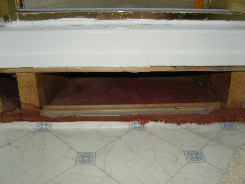

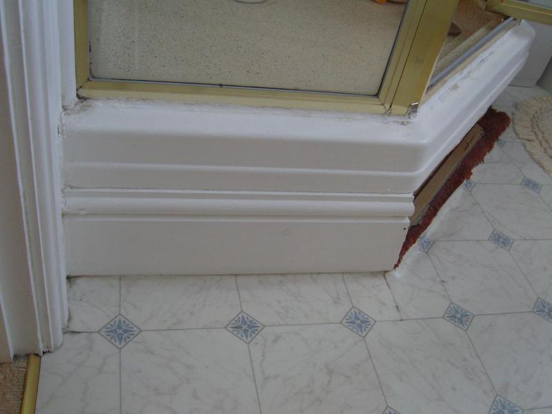

I've taken a couple of pictures of the skirting so you can see how it's been installed.

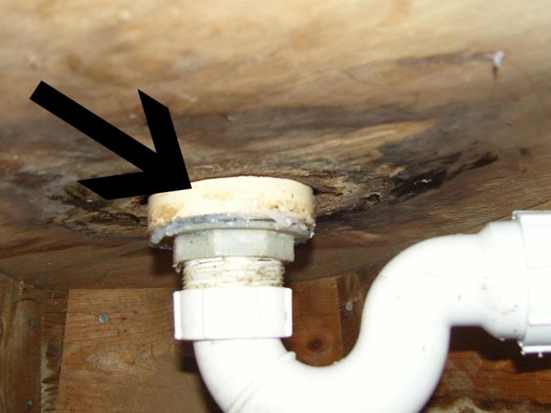

Thanks for the pics.
Woudl it be possible to mark on the photos where you think to water is getting out, your description is a little confusing.

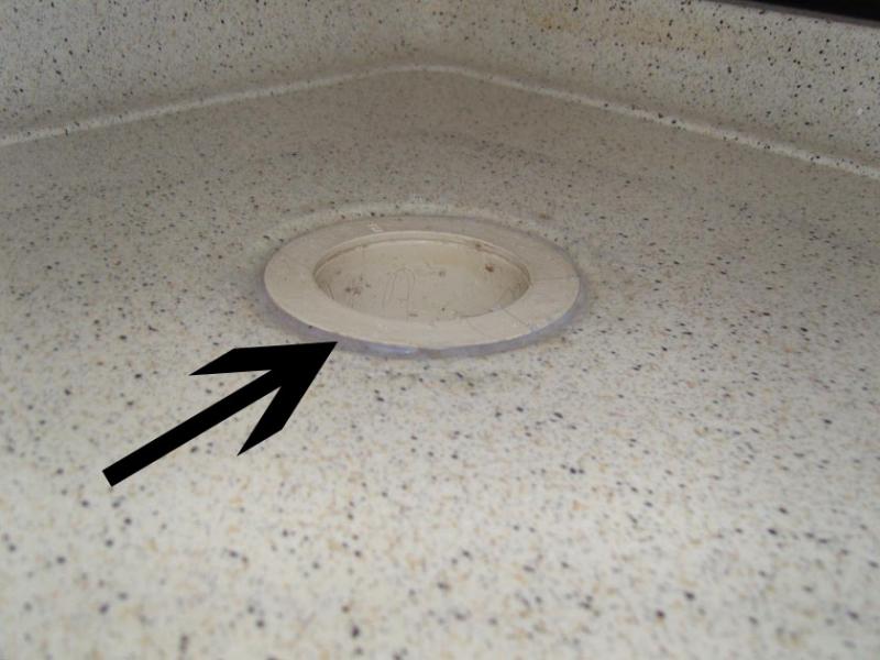

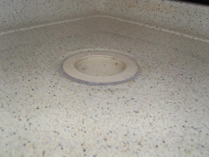

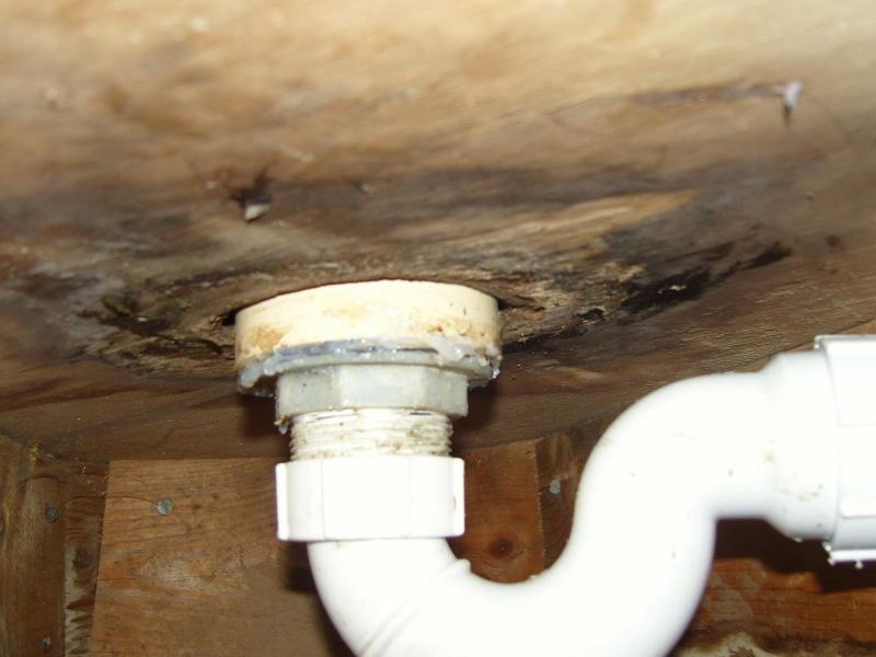

OK, I have pointed to where I think the water's coming from. From underneath it seems to be running down the outside of the tube bit. From the top I think it's getting under the lip where I've indicated. Hope this helps! I find it confusing enough so I can see why it's not coming over as well as I'd hoped.

From the photo, you may get one of those rubber band gripping tool thingy (Boa constrictors?) around the pipe to undo it. although I suspect it has been glued on :rolleyes:

1) The trap is new; it's what I bought from B&Q and what I put on. Before that it was just 1 pipe shoved onto the waste one end, elbow joint the other, no trap at all. The trap seen in the pics is fine and there's no leaking from the connection either to it or from it.

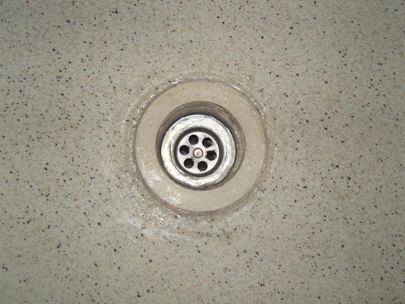

It looks to me that the chrome screen of the waste is to small, it should be large enough to go across the white plug. Looking down the hole you can see the edge of the black seal that is also seen from the underneath with the nut bearing on it but the nut doesn't appear to have anything to bear on, its not bearing on the tube you say the leak is coming from, it all just appears to be held in place by silicon.

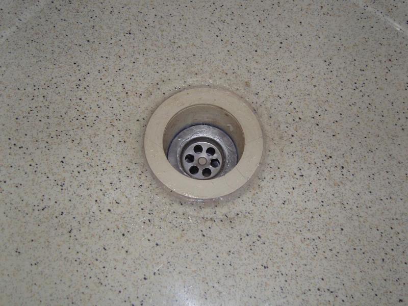

Yeah, the whole thing's just stupid really. I'll try and explain in more detail how the whole thing fits together:
There's a large hole in the tray. Into which is placed a tube with a lip. Under the lip there was, and should be, a rubber washer. This was then sealed with silicone sealant.
Inside the tube, near it's base, is a silicone ring. This is intigrated into the tube.
On this silicone ring, inside the tube the chrome waste sits. The chrome waste has an intigrated black rubber washer (which is what can be seen in the picture). It is not removable from the waste itself.
Moving under the tray now. You can see the thread of the chrome waste. Onto this thread fits another large, rubber washer. This and therefore the waste itself, is held in place by a plastic nut. Obviously, if one tightens the nut too much it'll just pull the waste through the silicone ring on the inside of the tube.
The trap then connects directly to the end of the chrome waste.
But, having said that, I must agian point out that the leak is not coming from this arrangement; it is coming under the lip of the tube and running down the outside of the tube, not the inside.

I think I can see where you're getting confused here; you're assuming that the tray is flush with the hardboard and, as I've previously said, there is a gap between the base of the tray and the hardboard. Let me see if I can explain:
Assuming you've read my explanation of the way all the parts fit together (see above) you will notice I say that the waste sits on a silicone ring which is inside the tube. This basically means that the top of the waste is level with the bottom of the hardboard. Do you follow? Assuming that this is the case, the trap you pictured will not fit; it's thread is not long enough. It will not, as you say, screw straight to the tray. I know because we looked at trying that as an option and it simply will not fit. Unless you can buy one that has a five or six inch thread. If you do please let me know and I'll be happy to try it!
