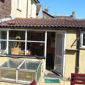

    Notwithstanding the snow load calculation method, the problem is that I am limited to a 65/70mm concrete lintel because I need height for the wall plate, but these concrete lintels are borderline for large spans. Having done some more thinking, is it acceptable to use timber for a lintel? That...

    Sorry for the slow reply, I've been away. I'm at about 80m ASL just north of Bristol and I got the snow loading from a contour map (can't remember the website) that shows 0.4kN/m. The weight of Redland 50 Double Roman came from the Redland website for min gauge (ie worst case)...

    Height is the issue. I want to get high enough at the front for a door frame, but higher at the back to increase the pitch. I'm already a block higher than next door's extension and don't want to go much higher. There's no loft space, and the walls are solid (single brick). My loading calcs...

    Thanks for the quick reply. It's about 2.1m front to back. The back wall is being raised also but that's the easy bit as it's all block with no openings, and the roof will be replaced (see other conversation in 'roofing' forum). I calculated the total roof load (for the new roof inc thicker...

    I need to replace the windows and door in an extension. It was constructed about 40 years ago and uses a single piece of 4x2 timber across a span of 3.5m. Above this are joists at approx 400mm spacing supporting a tiled roof at less than 15deg pitch. I want to install concrete lintels and...
