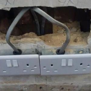

    The sockets connect to each other- there is no cable join within the wall, what's happening there is the wire comes into one, goes into the next, then comes out to go along to the next socket- it's a radial circuit. And yes, RCD protected. Timber noggins sounds straightforward.
  12. D
    Pattress box problem
    Right- go here for a small album: https://www.flickr.com/photos/8131181@N05/sets/72157644853848734/

    (I'm guessing I can't use an external image host) http://media.diynot.com/155000_154463_77828_94247512_thumb.jpg

    We live in a 1930's flat block, it's a concrete frame, internal walls are cinder block and external walls are cavity wall using odd, very narrow bricks- I've never seen them anywhere else. The bricks are VERY fragile, and in contrast the plaster is very, very strong- you can't get a nail into...
