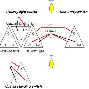

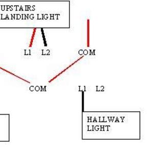

  6. R
    Adding extra light switch in hallway
    :oops: ..quite right.. i should have done really..the cable leaving the light switches are twin and earth so because I had some available I used it as well..but on relection this wasnt best choice really... otherwise you think that configuration should work?...i will give it a try...

  11. R
    many thanks for the reply...i basically swapped the previous RHS COM cable to L1 and the L1 cable to L2 and put a junction box in and connected the new cable to these in the J box and ran it to the new 2way switch and where i wired the cables into the coresponding L1 and L2. I then ran a new COM...

  15. R
    Hallway has 3 gang switch as below: LHS side of switch = single core red cable - outside light Middle = twin and earth - 2way to landing light (landing has single 2way light switch to hall light) RHS = twin and earth - 1way to hallway light I would like to add another switch at the other...
