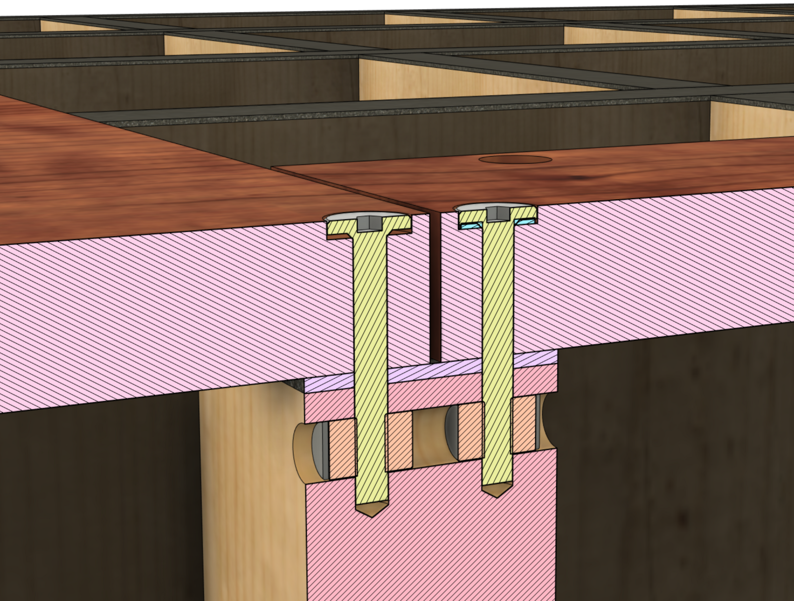

Hi,
I would hopefully like to avoid all the comments i know are coming regarding why i would ever WANT to do this, as i know its way overkill, i just want to know if there are reasons why i should not do it, safety and structurally speaking.
So i am putting down 25mm plywood in all the upstairs rooms in a house i am moving in to, but i want to make the flooring “modular” and removable like panels for easy access to mvhr ducting and electricals. My over the top plan is to drive myself insane and use cross dowels.. for the whole floor.. This would involve me drilling a 6mm vertical hole around 30-40mm deep in the joist, and a 10mm hole horizontally to meet the bolts. This would need to be around 30mm down the side of the joists, but i could go further if i go for some longer bolts.
Would this combination of holes compromise the joists, if done on 400mm centers? i am medium concerned about the vertical holes where the panels join, but i should still have 35mm of joist left over with 2 “side by side” 6mm holes, and they would share the same 10mm horizontal hole with a cross dowel from either side.
This decision was made, after considering that if i used threaded inserts, i would probably go equally as insane in the process, but they have the risk of pulling out of the joist over time and shredding it on the way out, which the cross dowel wont.
I am justifying this as an okay idea in my head because if plumbers can take big notches out of a joist without houses falling down, some holes with solid bolts inside shouldnt “cave in”
I will be adding noggins every 40cm also, with joist tape along all joists and noggins for what I hope will be a very sturdy and silent floor (for home theater/bedroom)
Thank you ever so much in advance!
You should be OK, but TBH your plan is completely OTT and to my mind just a tad bonkers - and may drive you a.bit further that way given that joists are never perfectly flat and straight and plywood can gbe a little warped, too, which will give you major alignment problems when trying to utilise furniture components desigbed forcprecision positioning and location.
It is probably just as easy to screw plywood rips down above the service runs with good quality screws, such as Spax screws (go for the Tx head ones in a 5 or 6mm shank diameter), then glue and screw the rest of the sheet materials down as normal

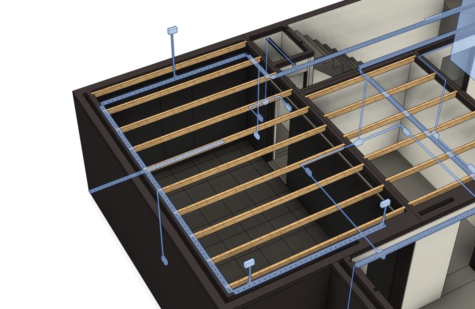

In reality you don't often need to lift floors in the way you are thinking, and in any case for easier access to electricals wouldn't the wiring have been better run in flexible conduits between oversize junction box "panels" (in the walls) like they do in Italy?
When in conduit the cables are downrated, and i want to keep them open in cable tray to keep their best rating possible. Yes it is going to drive me insane, but i have 1 month to basically do 2 rooms like this, then we can move our belongings up (bristol to newcastle, so not very fun with pets also).

Here is a model of my plan, the purple layer between the subfloor and joist/noggin is the green glue joist tape. I just dont know if that cross dowel is too close to the surface of the joist, or if i need to use 75mm bolts (45mm in the picture) to get them lower down, as right now there is only 5mm of "meat" above the dowels.

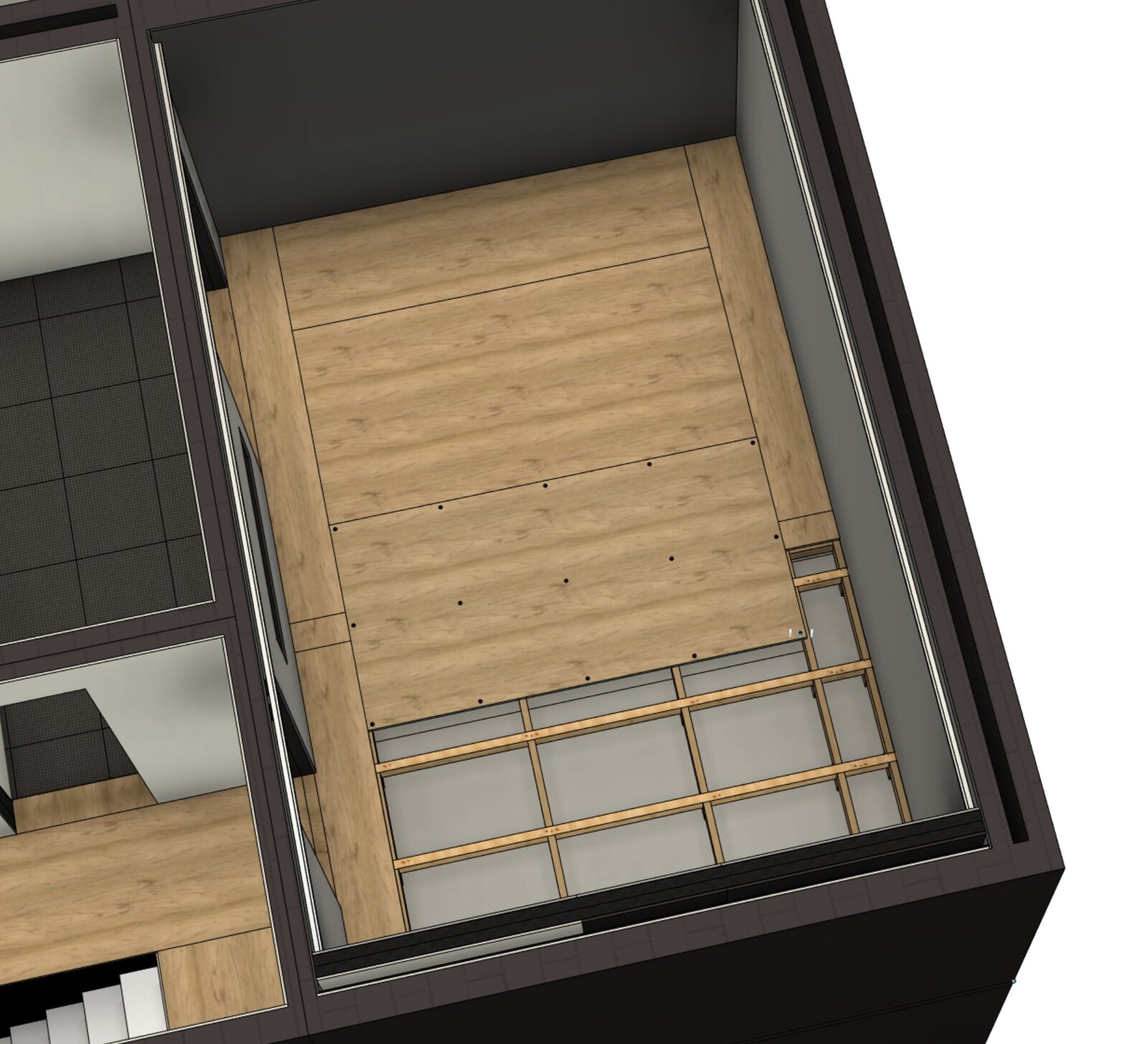

I probably wont be doing every single room like this, just the main bedroom and the pet room (so i can add more vapor barrier as needed, as my soldering/painting/chemical workshop will be right underneath them).

The threaded cross dowels will rotate and misalign. Not an issue for furniture as you can get your hand round the back. But a nightmare when you have blocked access with your panel.

If you're hell bent on doing it, I would want a fair bit of "meat" above the inserts - pulling down 25mm ply will require some force. You can stagger the bolts so they aren't opposite each other. As you are putting in dozens of noggins you could put the fixings in those so you don't touch the original joists.

I am doing the center of the room in exterior grade ply, and the perimeter in marine grade ply, so perhaps I could screw the middle ones and bolt the perimeter for access to the cable tray around the room, it would just make ducting access a bit harder.

Another vote for just using screws. I doubt you'll be able to maintain the alignment of the cross dowel nuts in the joists once you start moving around on the floor to fix them down. They'll vibrate around, end up misaligned and you'll have a nightmare trying to do them up.

I think an access hatch would be difficult, due to how i am doing the wiring, i have attached the "plans" to try and maybe show how i need to be able to access the edges of the room at minimum.
As for alignment when walking around before fully securing, i will just be placing the bolts in until i am ready to secure down the sheets to keep the dowels indexed with their holes.
I have to begin work this coming wednesday, with a 1 month time limit, so all your advice is making me think maybe i am biting off more than i can chew in this timeframe..
I will give it a go when i arrive once i get to the part where i need to do the flooring, if it doesnt work well or fast enough for a single sheet, i will switch to spax.
Unless ofc there are any structural concerns with the joists, though i think i will now try to redo this with the bolts only on the noggins.
