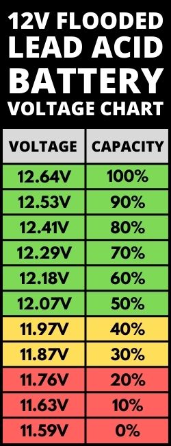

Thanks Eric that's all very interesting especially the bit about sulphur which I had never heard of before. But unfortunately it does not help me decide if the solar panel is no good :unsure:
Try this.
Set your M.Meter to 10A, change red lead & select 10A.
Connect the solar charger red lead to the battery + terminal.
Connect the M.Meter red to the battery - terminal.
Connect the M.Meter black cable to the solar black lead.
Read off the (any) charging current.
Disconnect the M.meter and ENSURE you return the M.Meter to "normal", otherwise, when doing normal probing, you will blow the 10A quick blow fuse in the M.Meter which should have one.

I would personally measure voltage at the panel first, start at a high volt reading and move down, it should show over 13 volts.
I would likely use a 24 volt head-light bulb, as I have some, across the output of the panel, I would expect a lower voltage, and I would calculate the load, 60 watt at 24 volt = 60/24 = 2.5A and 24/2.5 = 9.6Ω so if for example you measure 16 volts then 16/9.6 = 1.667 amps. So 16 x 1.667 = 26.667 Watts.
So using a fixed resistance I can measure the output of the panel. Without connecting it to a battery.
You can use the meter on amp range 1790092566991.pngto see charge rate, but in the main analogue multi-meters are not centre zero, these 1790091914837.pngare what I use to use, rather inacurate, but you again can't hurt them. But £37 for electronic clamp one (UNI-T UT210E) or 0-534-30 Durite meter at £29 I think I would go for the electronic clamp-on AC/DC meter.
I would perfer a diagram to connect A to B, as just too easy to make an error.
I think likely diode in the wrong place, or wrong way around, 1790092753196.pngmay be more like this 1790092947258.pngwhich will normally show direction on the diode like this one does
a zenor diode looks nearly the same, the sign is different
but a 14 volt zenor and a normal diode with a meter using a 9 volt battery will test the same.
