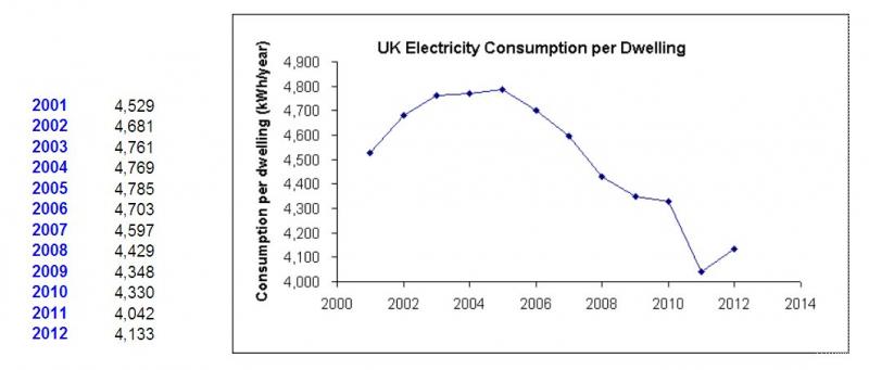

My intuition would certainly be the same as yours. However, government statistics seem to indicate that power consumption increased progressively and relentlessly until quite recently - domestic, industrial and 'other' (I wonder what that is?!) consumption all appear to have peaked around 2005, with appreciable reductions after that (with apologies for the poor quality rendition of my rapidly-put-together graphs!)....
Kind Regards, John

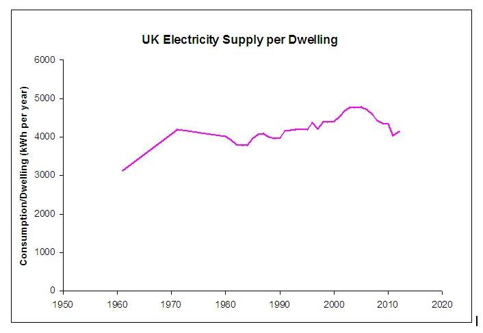

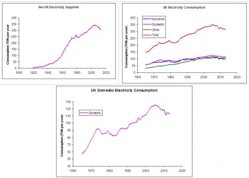

The near straight line graph shows 1951 at 15 million and 2008 at 25 million so if you compare eclectic power used per dwelling rather than per person then the amount of electric power used per dwelling has gone down.
Again, only markedly for the last few years (since about 2005). For the period prior to 1981, I only have to hand the 'number of UK dwellings' figures from the censuses (1951, 1961, 1971), and nor do I have a domestic electricity consumption (only 'total') for 1951, but, for the time being ....
Kind Regards, John

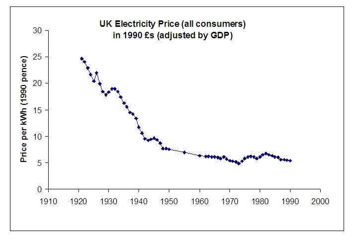

have you got a graph showing price per kWh?
With heating being the biggest domestic energy-user, and energy from electricity costing three times as much as energy from gas, no sensible householder will be tipping money into electric heating.
have you got a graph showing price per kWh? With heating being the biggest domestic energy-user, and energy from electricity costing three times as much as energy from gas, no sensible householder will be tipping money into electric heating.
The Department of Energy historic electricity prices data I have is odd. Firstly, it stops at 1990. Secondly, they have adjusted the prices (to 1990 levels) according to GDP, which may or may not b the best way of getting a 'real' cost. These figures relate to 'all consumers' (not just domestic) - presumably an overall average of some sort. I'll see if I can find some better figures ...
As you can see, there was relatively little change in 'real cost' (GDP-adjusted price) between 1960 and 1990. To give you a feel for the actual (not GDP-adjusted) figures, the price was 1.033 pence/kWh (actually 2.48 'old pence'/kWh) in 1921, 0.494 pence/kWh (1.19 d/kWh) in 1950 and 5.369 pence/kWh in 1990.
Kind Regards, John
