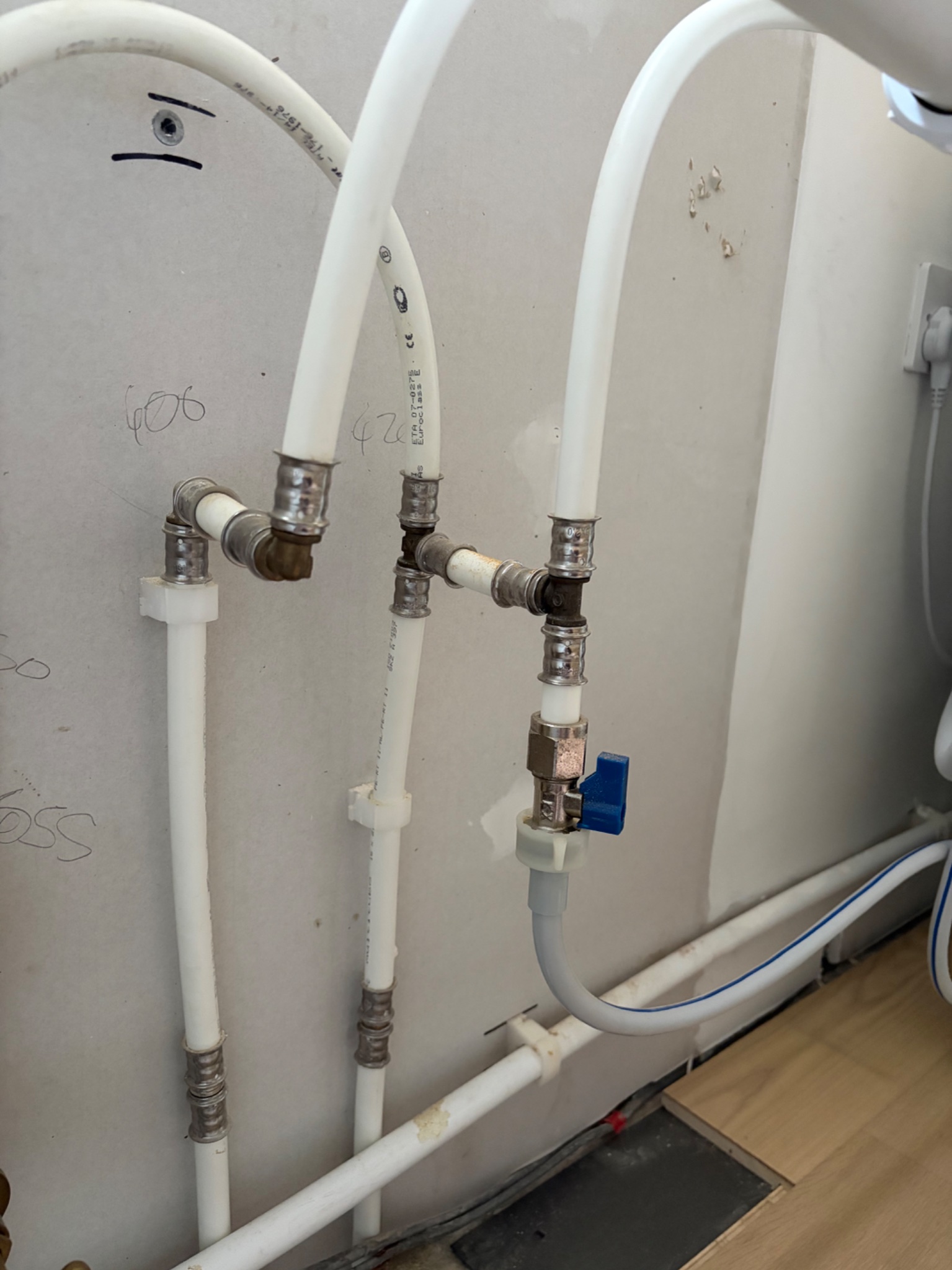

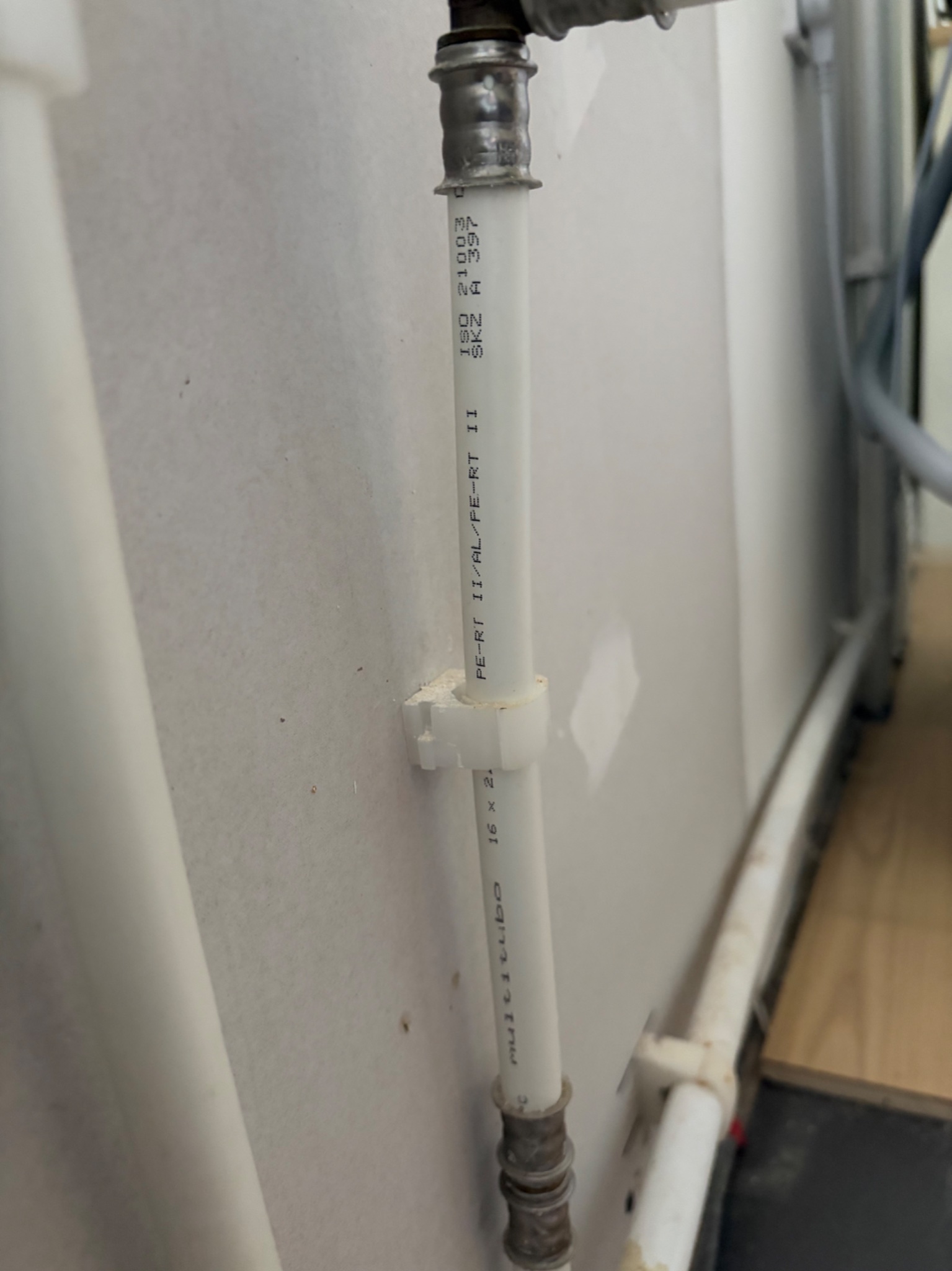

16mm multilayer pipe to 15mm copper
12 Aug 2026
6
I am currently renovating my kitchen and I am looking to alter my pipework behind the sink so that I can contain more of it behind the service void, however the pipes are 16mm multilayer pipe and I can’t seem to find a reducer to change these to 15mm copper. I also don’t wish to use a press fit fitting. Can someone please advise.
See below:
Andy
Thank you very much, I received this part today and I have ordered a Knipex 90 25 25, can you please recommend a good bevelling tool for mlcp, can I use any mlcp bevelling tool or does it need to be brand specific?
