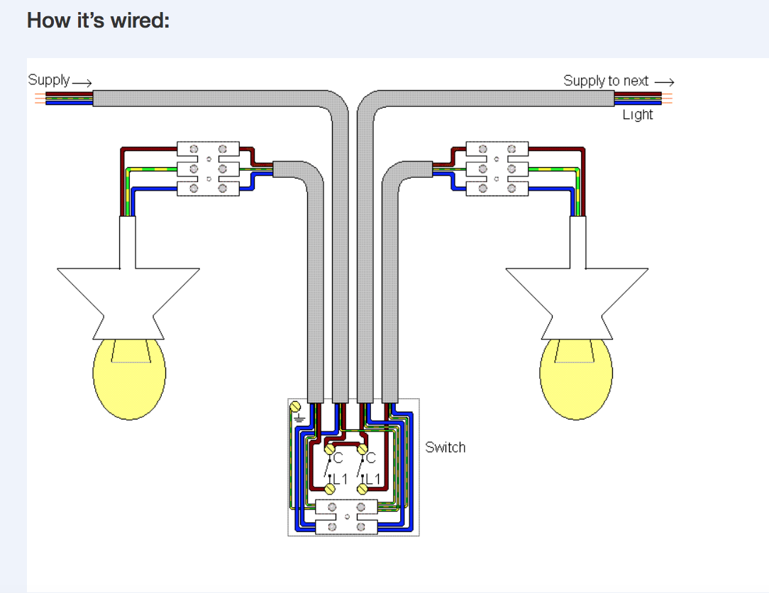

Right can anyone help, I need to run an outside light along with a light under a kitchen unit.
Could I come off a fused switch to a 2 gang switch and power both?
If so how would I wire it so the 2 gang controls each one independently?
