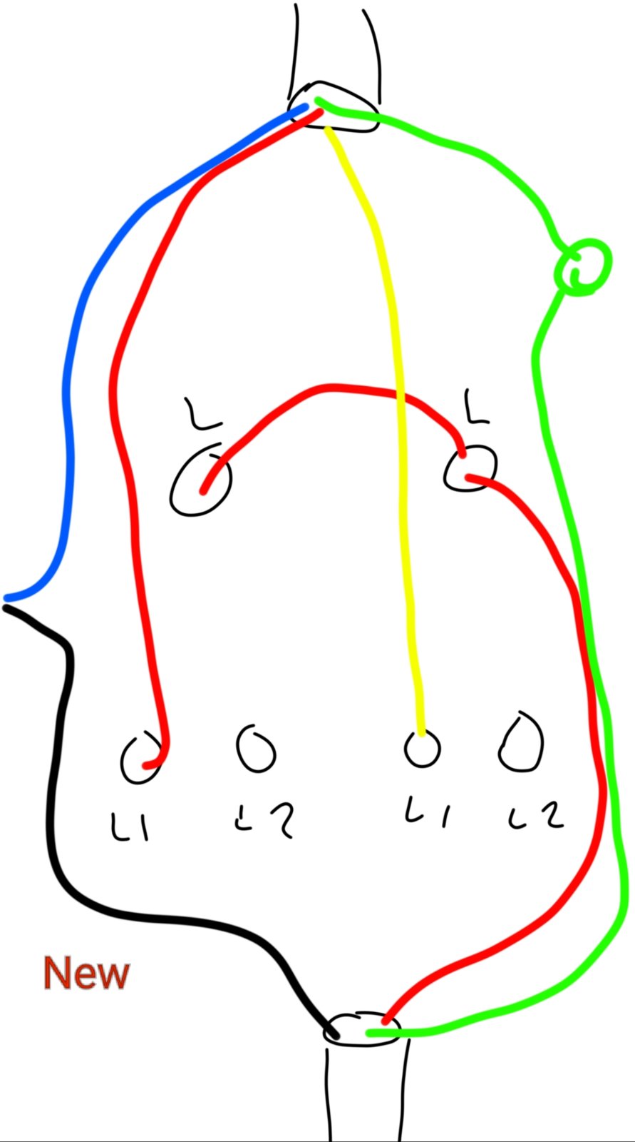

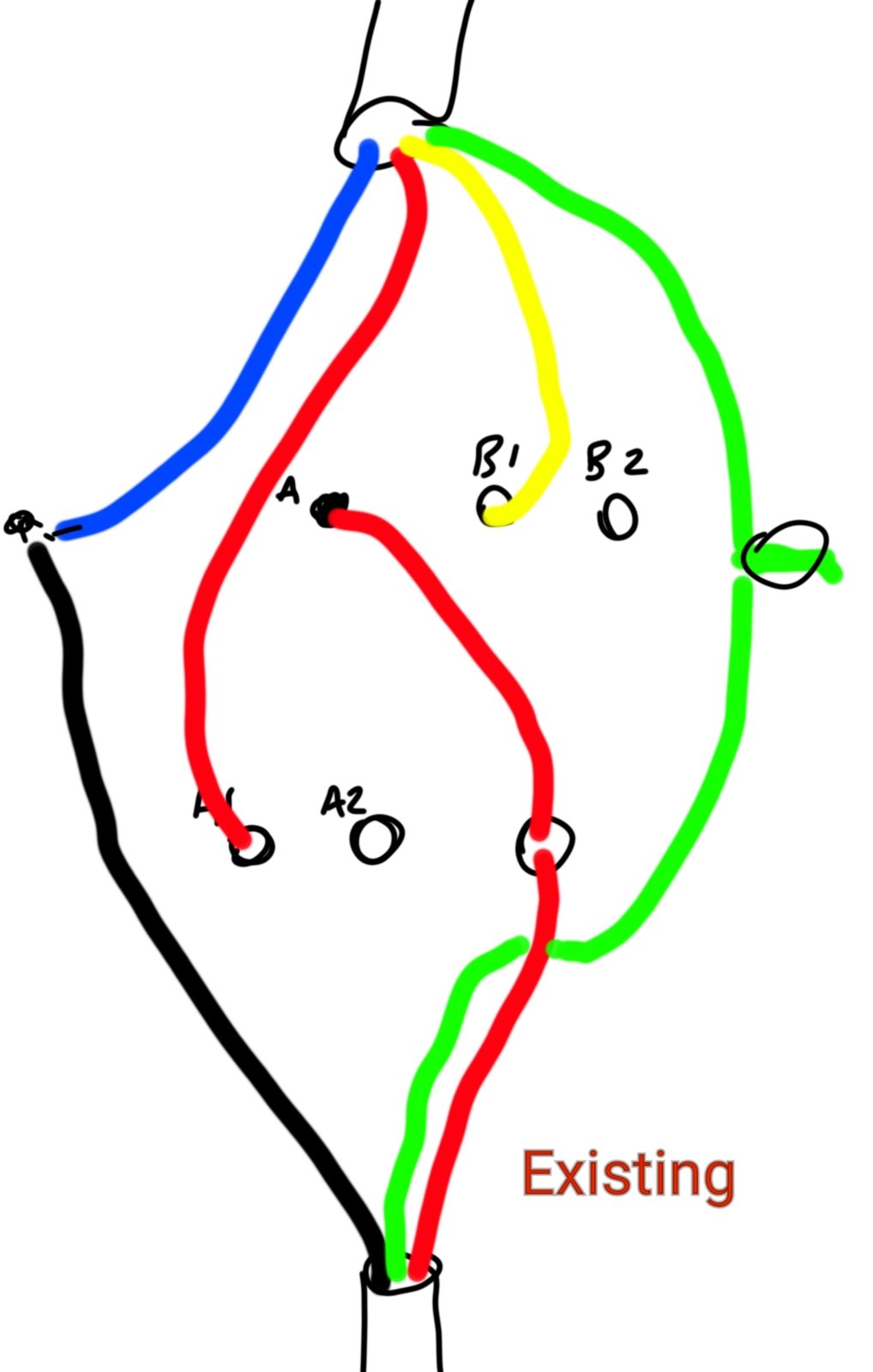

I have an existing light switch wired like this (labelled existing).
The new switch looks quite different. Have I got the right idea about how the new one (labelled new) should be wired?
Thanks. What is the yellow wire going to the second L1. I couldn't see that in any the books I have.
I should have said, this is to control two lights, one outdoor and one in the porch. There are no other switches for these lights.
