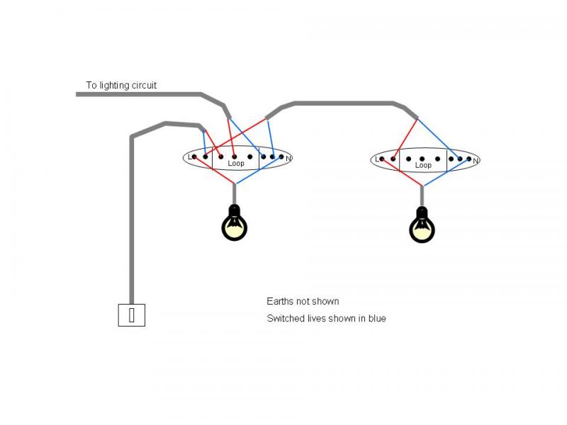

Hi,
Can anyone verify that my diagram below is the correct way to wire 2 lights to a single switch using loop-in method? The lights are at the end of the radial light circuit so there is only 1 loop cable.
My main issue with this is on the first light there are only 2 live terminals in the flex connector block but I have 3 wires to fit (1 switched live, 1 flex live and 1 live to the 2nd light) - so am I ok putting 2 wires in 1 terminal?
