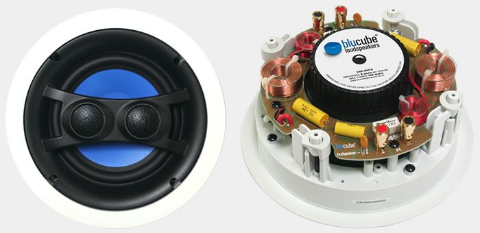

Hi Guys,
I currently have a hi fi in the bedroom with a left & right speaker.
To de-clutter/remodel the room I am thinking of putting in a single stereo speaker in the ceiling.
Can anyone suggest a way of making the 2 speaker (mono) signal convert into a single stereo output for the ceiling speaker.
I have read about using a summing mixer - 2 10k Ohms resistor on both outputs, then the resistor outputs are bound together to feed the stereo speaker.
Is this a method anyone has used?
Many thanks

Singe stereo speaker ???????????????
Yes, at line level, but not at loudspeaker level.
Couldn't you use two speakers, one for each channel?
What you're planning isn't the best idea.
You'd be better off with a simple Speaker Source Switch.
This will allow you to connect the speaker wires from both stereo systems to a box that then acts as a simple "A or B" switch. It will route through one Hi-Fi signal at a time but not both together. (In logic terms, it's a NAND switch) This means that the power from one Hi-Fi goes to the speaker and not to the speaker and the other system. You'll also preserve the "stereo" element of the signal rather than reducing to two monos.
There's a used one of these on Ebay right now for just £15. I'd say that's perfect timing. Here's a LINK
Well, single rather than singe; but yes, these things do exist.
It's a ceiling speaker with a crossover and audio filter circuit. The bass gets filtered off to a mono woofer. The high frequency left and right signals remain intact and are fed to a pair of tweeters. Here's an example of a good quality version Bluecube CXC 650-S @ £299

Ah, for some reason when I read the OP I thought you were trying to connect two Hi-Fi's to one stereo speaker. My apologies.
So, what you've done is purchase x2 in-ceiling stereo speakers. Is that right?
If so, then the answer is simple. Drive one input on each speaker. Leave the other input disconnected. The speakers will act as plain 8 Ohm mono speakers just as if you'd bought a regular pair of in-ceilings.
An inceiling stereo (if properly designed) should provide the amp with the same load as 2x 8 Ohm speakers (ie 8 Ohms per channel: 8 Ohms for left, 8 Ohms for right).
Summing the left and right inputs on the speaker will create either a 16 Ohm load or a 4 Ohm load for the amp depending whether you wire in series (16 Ohm) or parallel (4 Ohm). At 16 Ohm you'll lose some level but the amp should cope. At 4 Ohm you risk the speaker sucking more current than the amp can supply. That'll be a problem and could result in you blowing the amp's output transistors and possibly frying a voice coil or two as well.
Try running the speakers single channel. You won't be losing anything and you'll keep the amp happy.
If you really must drive both channels on both speakers then look for an impedance matching speaker selector. Decent ones of these include passive transformers that balance the speaker load so that the amp still 'sees' 8 ohms per channel. You will lose some level via this though.

I really can't see how that speaker could pretend to produce stereophonic sounds, as there is virtually no separation between the two tweeters.
Has anyone any direct experience of them?
Yes, I install them quite regularly.
If you're comparing them to conventional bookshelf/stand-mount/floor-standing speakers then I can see your point, but what you're missing is how the application changes the requirements.
This isn't "sit down and listen seriously to precision stereo imaging" Hi-Fi. It's about good quality sound reproduction in a variety of different and sometimes challenging spaces.

I think you're still missing the point. You wouldn't buy two of these to run as a stereo pair (despite that being exactly the mistake that jassdhali made). It's not two tweeters for the left channel and two tweeters for the right channel in place of a single tweeter/woofer conventional stereo pair. So your question whether two tweeters sound better than a single tweeter in a conventional in-ceiling speaker really doesn't make sense.
The top end frequencies remain channel separated. There's the left channel and the right channel. There's one tweeter for each channel. The two tweeters are in close proximity because they have to be housed in the single speaker basket; but they're still acting the same way as two individual speakers for the treble. Bass is omni-directional (in theory). So the bass goes in this speaker from the L & R channels and gets summed to mono because there's one woofer.
