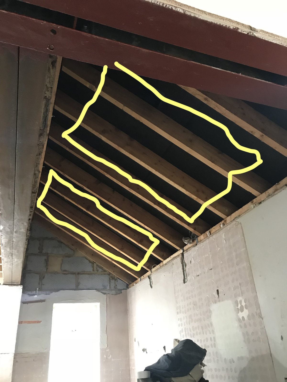

Hi all,
Looking to install 2 SK06 114x118 Velux windows on the roof of my existing kitchen extension.
As shown in the photo, I will need to cut out 2 rafters for each window.
This will leave 2 rafters each end of the roof, and 2 in the middle. I am planning to double up each remaining rafter and double up the trimmers.
Does this sounds right or would this be too much weight for it to take? Rafters are 6x2s.

Yes, double up the rafters and the trims.
Also, looking into Velux window flashing kits. Having two close to one another, individual flashing kits might overlap so you can (I think) buy a double flashing kit. I would check that out first because this will give the spacing between each Velux and avoids having a skinny cut tile between them.
And, read the velux fitting brochure. Bottom trim is vertical, top trim is horizontal. This is to allow maximum light in. I find very few joiners who know and do this.
Easy to draw some lines where you would want them isnt it? Unfortunately this doesn't always work out. before you decide on sizes you need to check where the battens lay As the bottom of the windows should be set out the correct distance from the last batten that runs trough below. Or the flashings will play up.
If you look around you will no doubt see plenty of Velux and the like looking untidy with bits of lead hanging out etc.. It's usually because they are not positioned correctly.

I'm not concerned about the battens. When the tiles are off we will sit the Velux correctly as you suggested. My draws and questions are based on the structure stability of the roof once I cut 4 rafters and replace with Velux windows. Thanks.
