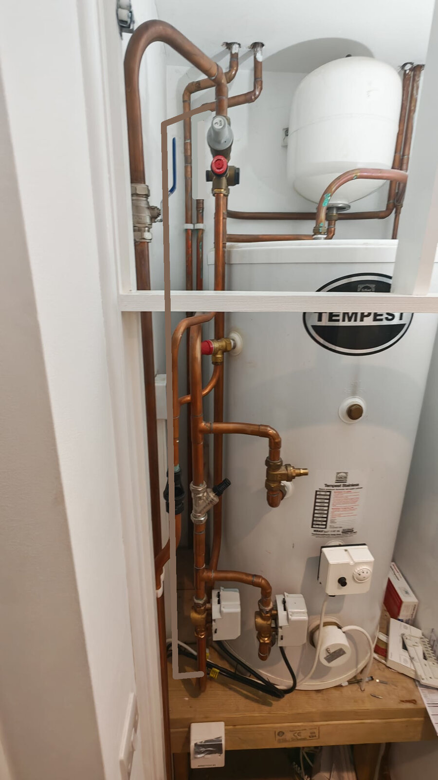

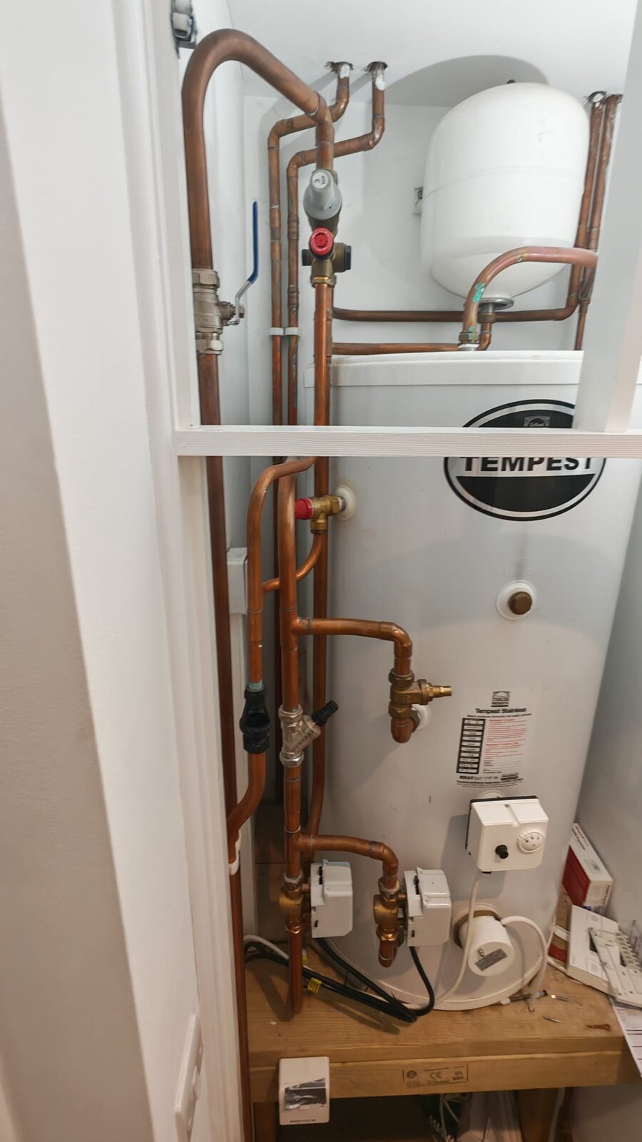

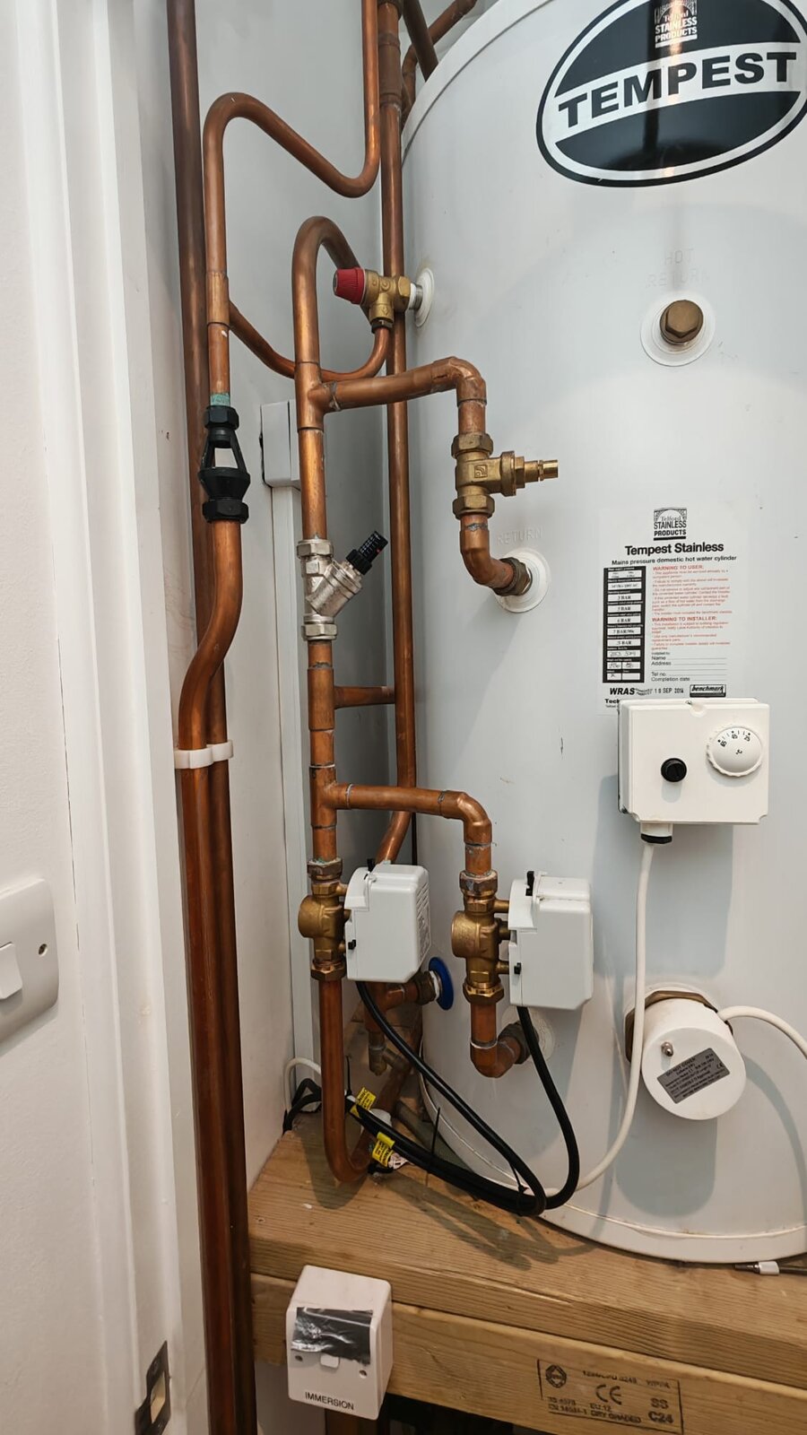

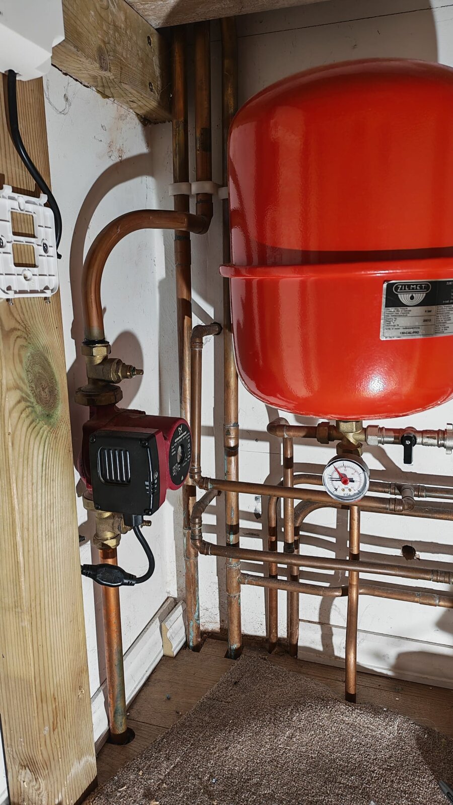

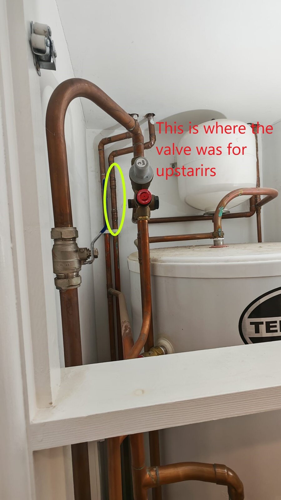

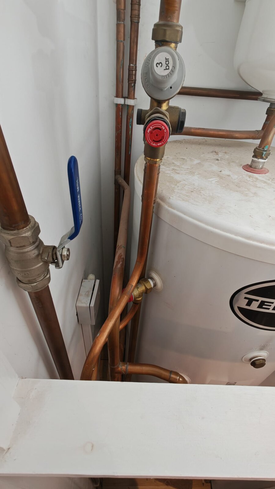

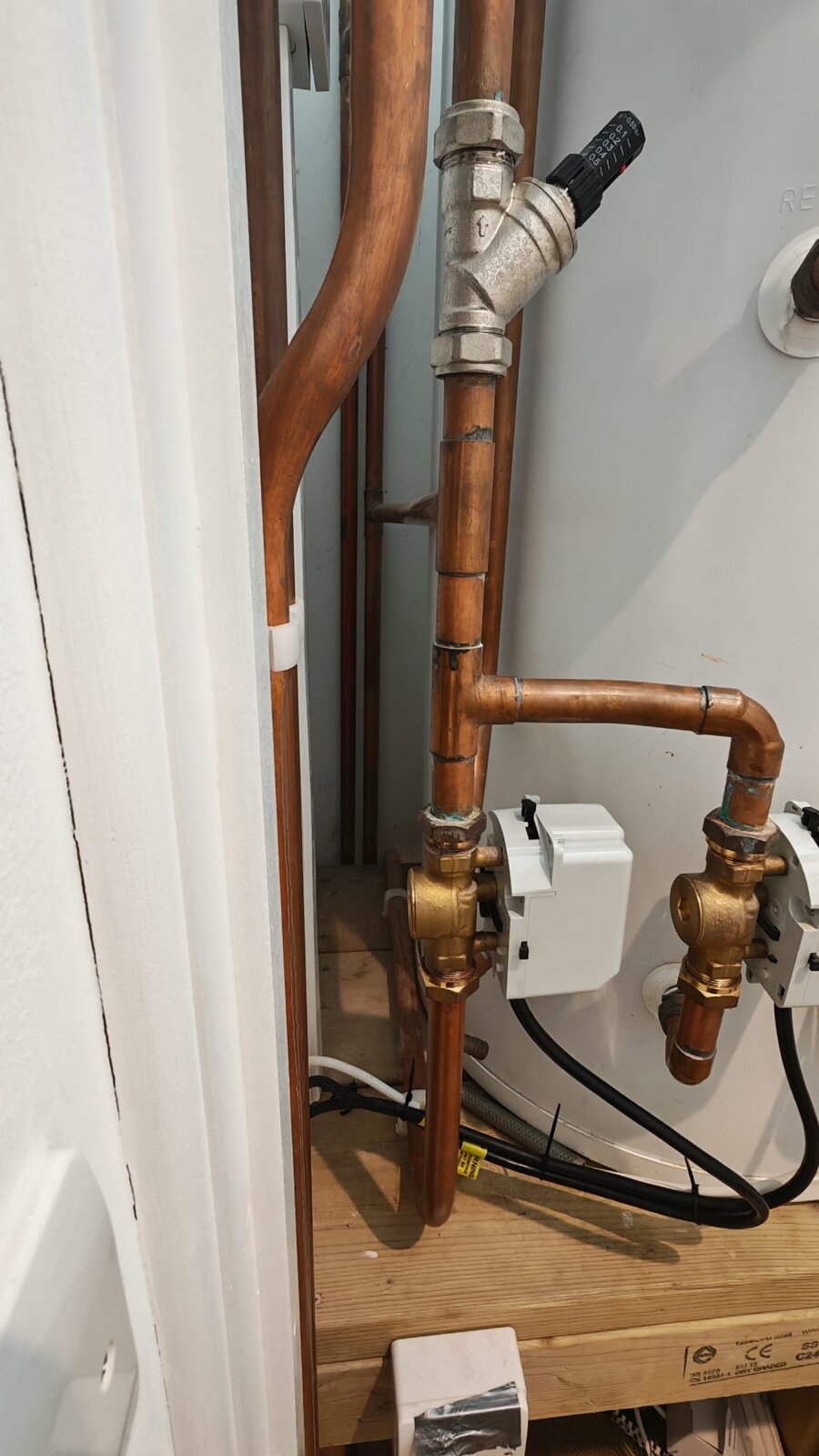

So first post here and really hoping you can help.
My setup is a Boiler with a megaflow and originally was a two zone heating system one for upstairs and one for downstairs. To cut a long story short, due to a faulty motorised valve it kept tripping the boiler. I no longer wanted the two zone heating system so I removed the upstairs motorised valve and replaced the faulty one, however when i put the hot water on the upstairs radiators come on. Can anyone tell by the pictures provided how the pipework should now be re-run now the upstairs zone valve has been removed?
Many thanks.
Your upstair zone, is now plumbed, straight onto the flow of the boiler, and so any demand on the boiler will result in the upstairs zone receiving heat. The simplest solution, might be to refit the zone valve for the upstairs. If that's not possible, then the upstairs zone, where the zone valve was, needs to now be connected to the output of your now single zone valve.

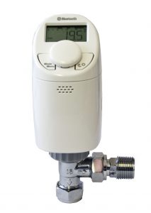

has a microswitch in it, but the zone valve at the radiator EQ3-Straight-213x300.jpgdoes not, so we want some way to tell the boiler to fire up. So we end up with a hub,
somewhere to connect to both TRV heads and boiler to tell the boiler when to run. We want a zone valve for the DHW so we can control the temperature to below that of the radiators, but it is clearly cheaper to install a system to control large sections of the heating, rather than individual rooms, but to put both TRV heads and in pipe zone valves would be like installing RCDs which in turn feed RCBOs. We want either/or not both, as they do the same job.
