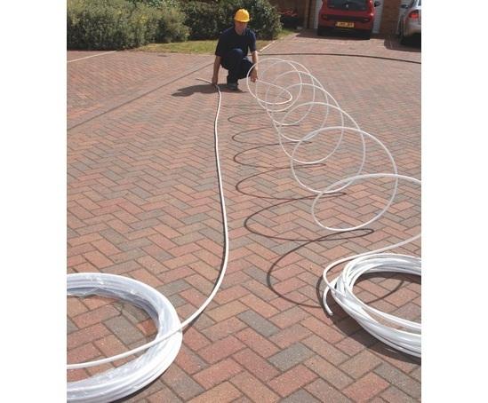

used 22mm in a coil, which is a pain to thread through holes without help from another person, even when you leave it to warm up slightly
I guess this is the reason I can't seem to find 28mm JG in a coil, say of 25m or 50m - because it would be a nightmare to use?
I notice that hep20 do a roll though, any ideas why you can get 28mm hep20 and not 28mm JG?
of course, I might be wrong - so if you want to prove me wrong send me a link to 28mm JG in a coil ;-)
You have just answered your own question, "it would be a nightmare to use" Speedfit pipe is generally PE-X (they have started selling PB at a premium price) all Hep2o pipe is made from PB (Polybutelyne) which is far more flexible, a large number of plumbers do not use 22mm coils of Speedfit but use straight lengths and couplers, sort of defeats the "Flexible Plumbing" theory.
Once you have used PB pipe you will wonder why did I bother with PE-X
