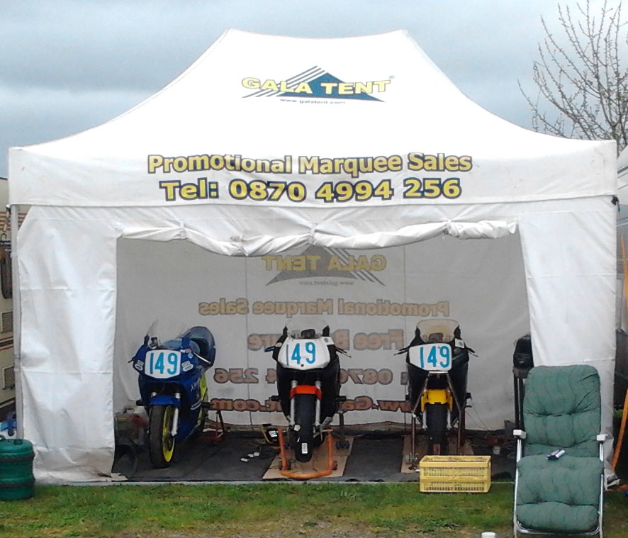

In an attempt to ditch lugging around my 3Kw petrol generator to power the tyre warmers for my race bike I stumbled across this - https://www.ebay.co.uk/itm/2000W-40...572673&hash=item466b233465:g:BqoAAOSwLgNaaqVk
My tyre warmers (front & rear) draw 4A & 4.2A @ 230V measured with a clamp meter plugged in at home, which puts me around the the 2Kw that the inverter quotes, but is it too good to be true?
Also, Ive no idea what the average family car can put out as I reckon I'd be drawing around 165A @ 12v (maybe a little less as the voltage will be higher with the engine running).
Just to give you an idea what it's for, you can see the generator in the background on the right, but it's chuffing heavy because of the engine and fuel, plus it takes up half the boot of my car.
