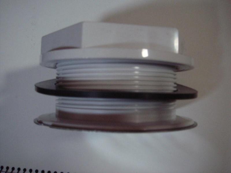

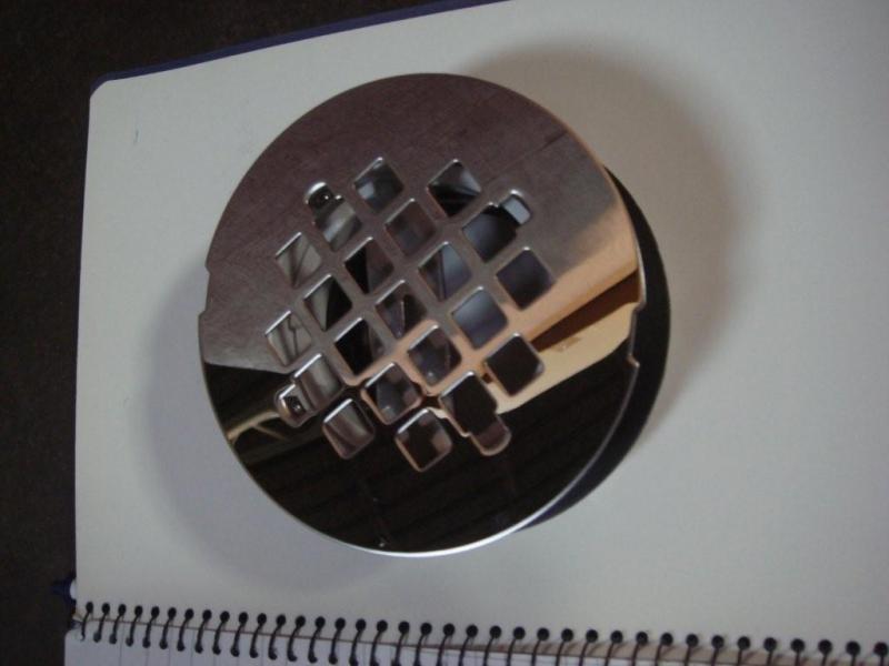

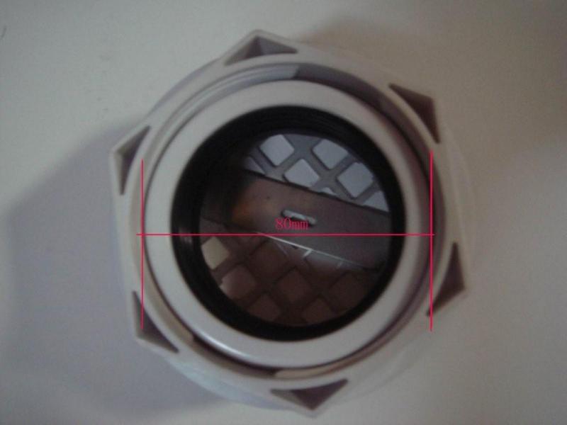

I have an artificial stone shower base here which I'm installing, which has an 80mm waste hole in it, which I obviously need to connect up. I am unfamiliar with this, so I am asking what you recommend with this.
Can anybody offer any solutions?
Thanks, I appreciate it.
Hi, Is the bottom threaded or does it push straight into a 3" soil fitting.
Probably the best place to ask is where you got the tray.
The only fittings I can think of would be Vulcathene.
The thread would be 21/2" bsp I suppose, so wouldn't be a problem from that.
BSS are a good supplier for Vulcathene although it may not be on the shelf, it's where I would start.
Have you ask the supplier.
I can see endless supplies of 90mm drainage across the net. Can you amend the drain exit hole?
