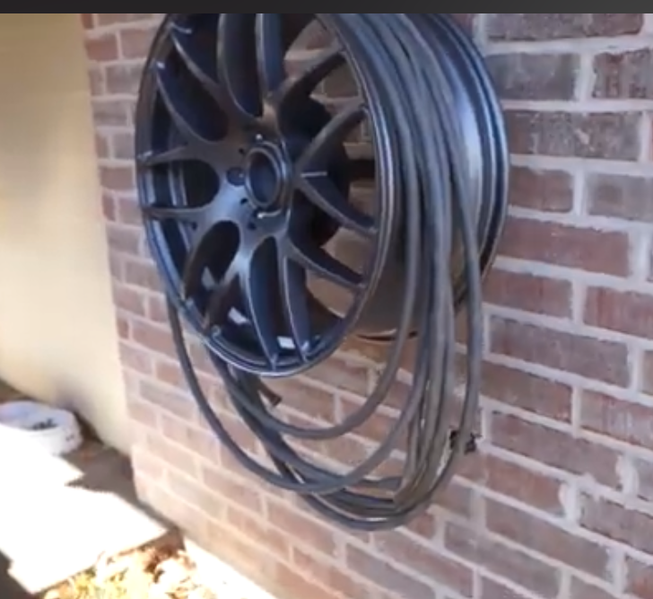

Found a 25m 25mm ID hose on eBay for 70 quid (not the cheapest, just the first); all in and for what you'd pay for some fancy hozelock retracting reel thing it's in the ball park. I'm so gash I'd just screw an old car wheel rim to the wall and hang big loops over it to wrap it up
