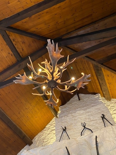

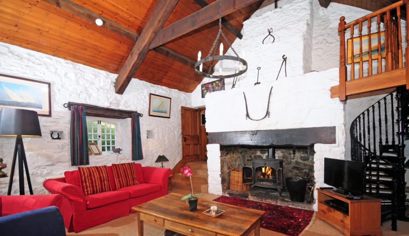

Picture to give you an idea - i'd like to keep the main beams exposed so have circa 100mm to play with.
