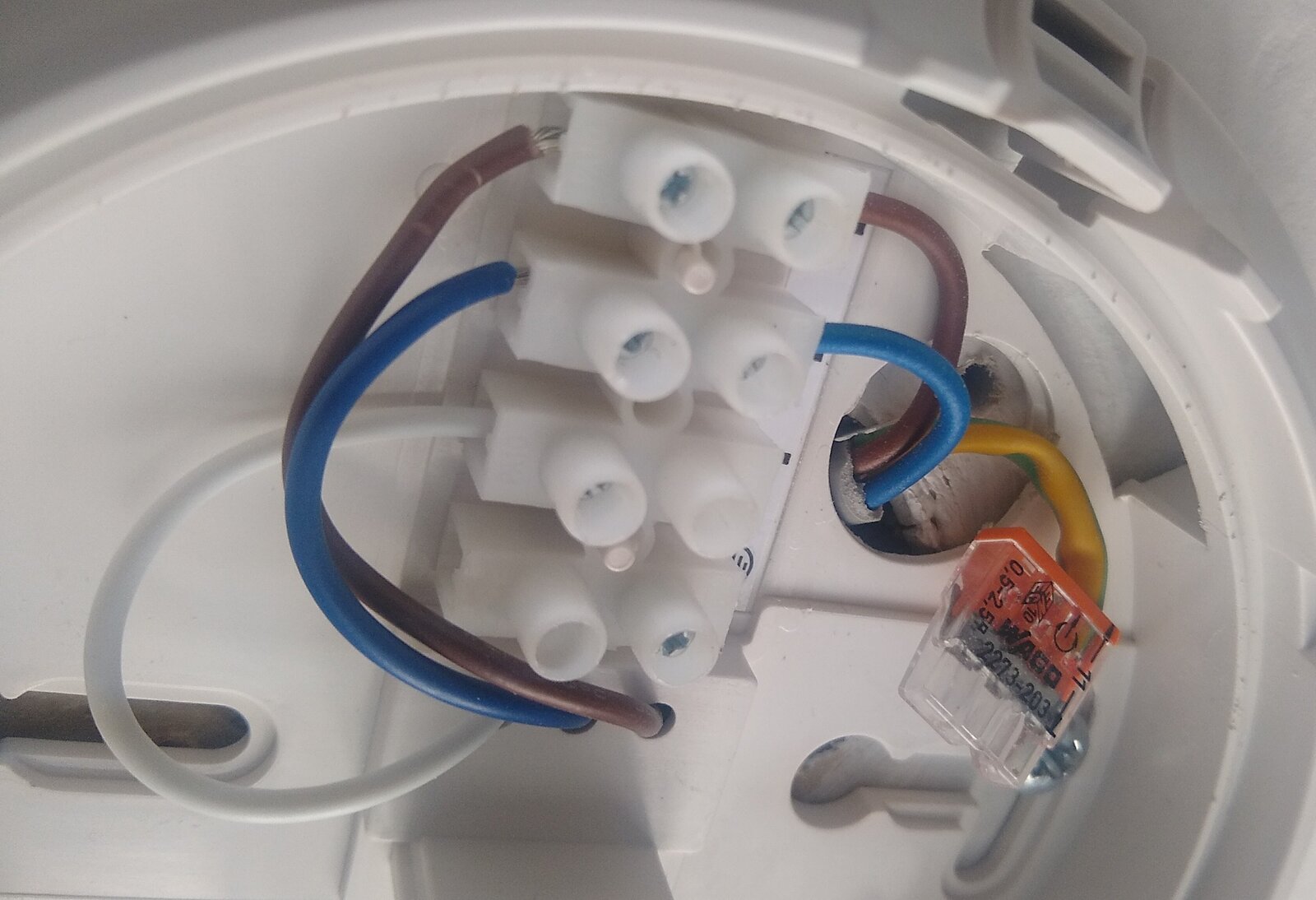

I'd like to add a light to corridor in my home
Currently, the only electrical item in the corridor is a smoke alarm (which is powered by the lighting circuit)
To create the new light, can i simply take power from the smoke alarm and connect this to a Quinetic receiver in order to create the switch for the light?
Hacking walls is not an option

Mains voltage smoke alarms are often (now, usually) interconnected and not simply hung on the lighting circuit.
Yes, but the L&N are just part of the lighting radial circuit. I doubt that the OP would mess around with the interconnect conductor, why would he?
I don't know, I can't see the connections.
They are more or less all the same.
We could ask the OP to post a pic for you, if you like.
@veedee can you do this for JohnD. He’s not sure.

In my case, the alarms are not interconnected

Image attached
the white wire, seemingly not used. Is that for potential interconnect?
Yes
If the alarms are to be interconnected with cables, the normal method is to bring a mains feed to the first alarm, then 3 core and earth Cable from the first alarm to the other alarms. the 3 cores bring live, neutral and alarm interconnect.
this means that all alarms sound if any of them is triggered. Also all alarms can be silenced by pressing the hush button on any alarm.
