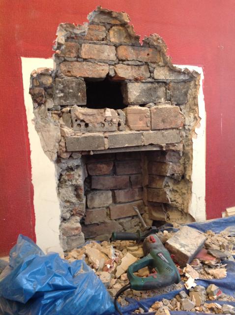

So step 1 for me was to strip back the plaster and see what I find:
I removed a brick so I could see inside, and it looks like there is a single skin of bricks leading right up to the archway - the apex of which is about 14 bricks higher than the hole I made.
I think the lintel is an important structural piece and if I remove it and the bricks either side of it, much of that outer 'front' skin of bricks would likely fall away.

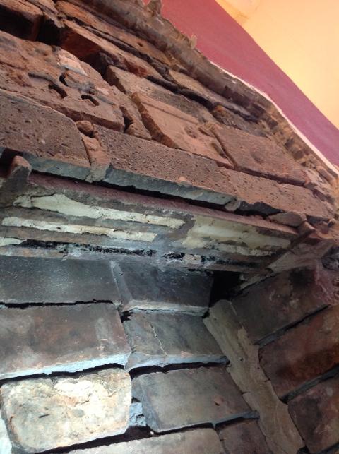

Heres a pic of the lintel:
I'm unsure of how to proceed. Any ideas? I'm thinking that I will need some kind of temporary steel support device to hold up the front bricks, then I do my removals, then re-lay the back and sides up to the level of the steel support, then install some kind of permanent support/lintel. Perhaps angle iron or something?[/img]
Definitely worth mentioning that we will not actually be using the fireplace for a fire - we're blocking it off (but putting a vent in to prevent bad stuff happening with damp etc) and we're just having it for decorative reasons.

1. You need an "Acrow Strong Boy". Once its inserted you can safely remove brickwork for conc lintel or angle iron.
You could get away with 75mm bearings.
2. The damper/ ironwork up the flue, including the present "lintel" can be safely removed with no detriment to the c/breast.
3. There's nothing "tricky" about inserting either lintel, merely open up 700mm to the desired ht. and then take a brick away on either side for bearing, insert your lintel and lay some bricks or wedge them up with slate or plain tile.
4. Dont go removing or opening any more than is strictly necessary, and stay away from the outside corners of the c/breast. Your iron "lintel" appears to be a cast iron fire grate or grill.
5. Your vent positioning is correct.

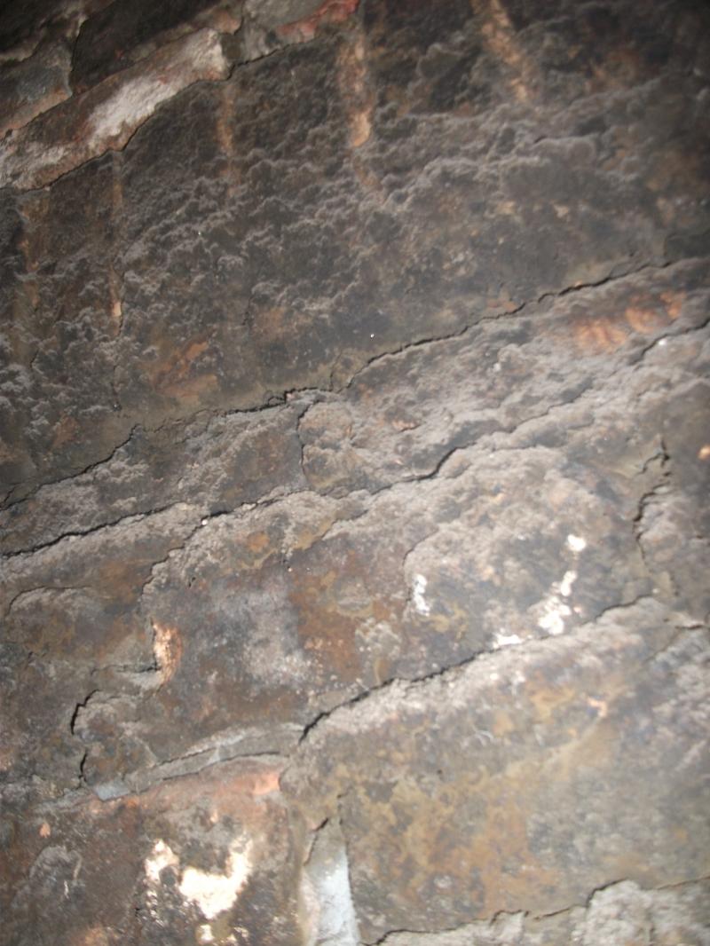

I think I may have spotted my 'main lintel' using a mirror and torch to look up the inside of the chimney - if it is actually a lintel then its a fairly thin piece of wood, can't be more than 1.5" or so thick. Not sure what state that would be in given that the house was built ~1890.
1. If i was doing the job then i wouldn't even use a Strongboy. However you are a DIY'er and you asked and i told. Use a single Strongboy.
I'm concerned that you claim to have seen a piece of wood up the flue. How far up? Wooden flue lintels were never used, to my knowledge, in small dwellings, and they certainly wouldn't project into the flue itself.
More info and a pic please.
If wood is in there, then it has to come out - if not for you, then for future occupiers safety.

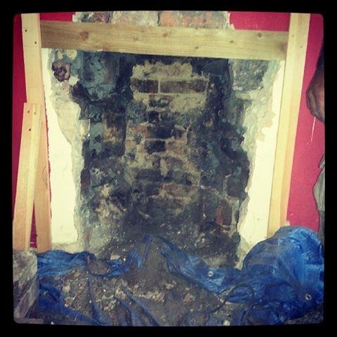

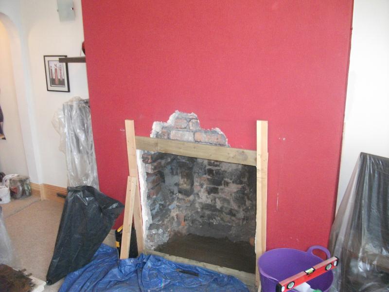

Instead of doing it properly and renting an Acrow/Strongboy, I've made my own from offcuts of wood and a heavy duty angle bracket:
An acrow would have had to go in the centre, which would have been right in my way, so this has worked out better (for now!)

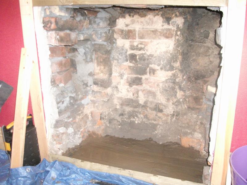

Here is the current plan:
1) Excavate more on the sides (roughly to the vertical lengths of wood in the picture)
2) Clean up!
3) Level up the base using concrete, about 1" - 1.5" should be ok, with some scrap sheet wood and maybe plastic sheeting under it.
4) Lay the bricks (the interior area will be 300x600mm and the height will be 900mm). This will be the hardest phase as I've never laid bricks before, and these have to look perfect or the wife will complain :)
5) Lay the new lintel on top of the bricks. I have a 900mm lintel so that leaves a generous 150mm bearing each side, meaning I'll have to excavate at least a further 60mm on each side
6) Use mortar to fill up the remaining space between the new lintel and the old course of bricks above the lintel. Ideally this gap would be under an inch, but I'm going to have to trust fate on this one ;)
7) Install fixings for a 'floating-shelf' style oak mantel, that I have not sourced yet. Not sure how I'm going to do this, I've not researched it yet.
8 ) Install mantel
9) Render the exposed bits of the wall and skim over with plaster
10) Pour some more concrete for the bit infront of the hearth (so it will be raised about an inch above floor height)
11) Lay some nice stone tiles on the base
So quite a lot to do!
I've had a good look inside the chimney and cannot find any lintel at all, just 5 courses of horizontal bricks followed by a decorative course of vertical bricks, then I can't really see after that because of the layer of ash. Here:
This worries me a bit as I had assumed there was a lintel, so worst case scenario would be 4-5 courses of facade-bricks would fall down....now the worst case is a bit worse. The bricks themselves seem to be doing a good job of holding themselves up, and the opening is only about 80cm which shouldn't be enough to collapse it even without the DIY-prop.
So I (carefully!) finished my demolition and poured a mortar base about 1" thick. Levelled it nicely (bubble right in the middle 8) ) and I'm currently waiting for it to go tacky to smooth it off.
I won't have time to do anything on it for a couple of days so that'll give it time to set - then bricklaying can commence!
