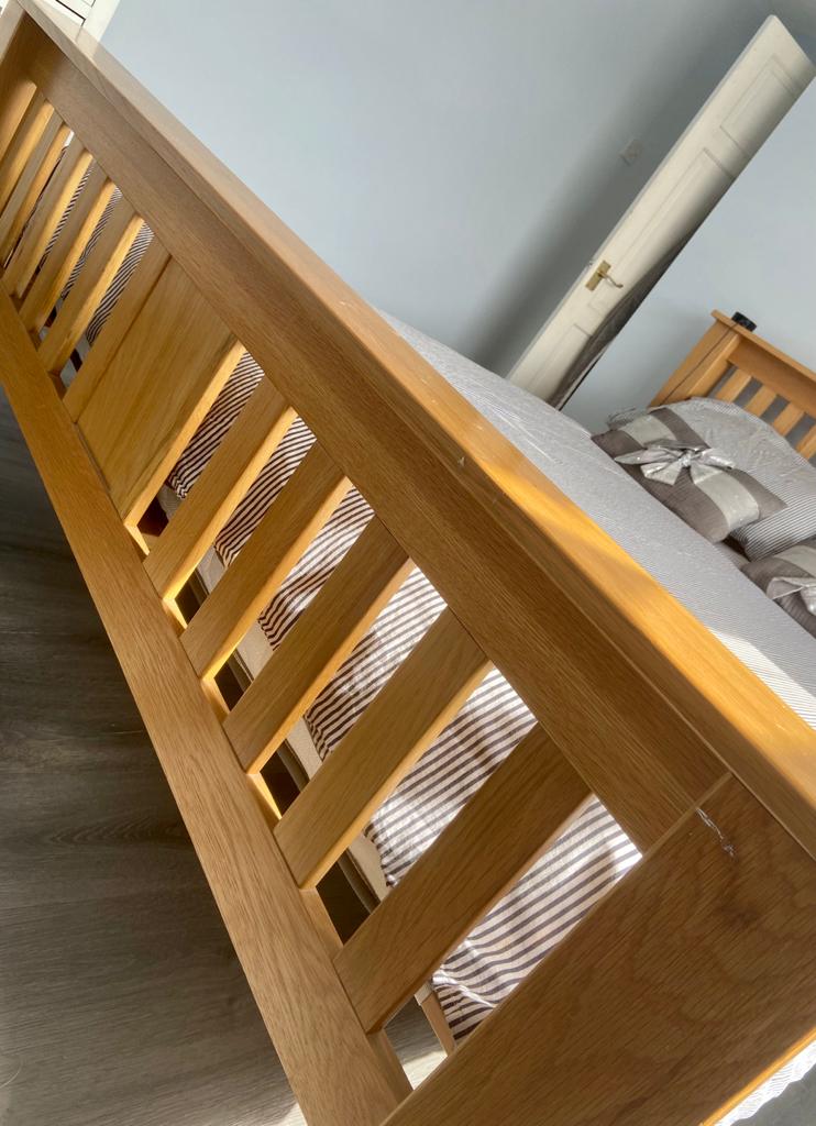

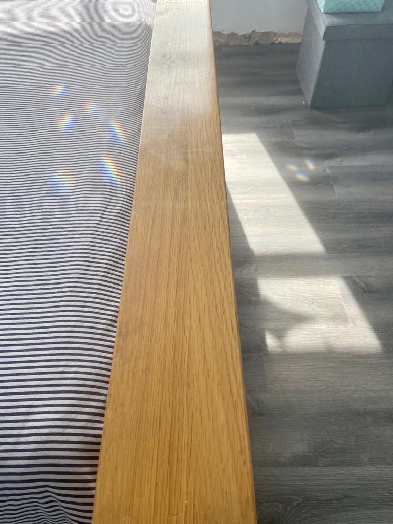

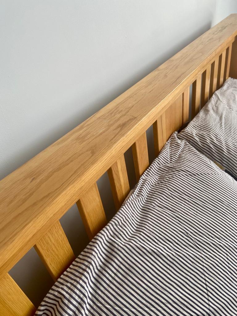

I’ve uploaded some pics........ I think
I would guess that it's sprayed with a lacquer?
I'd be tempted to test a bit on the back first. I would guess that zinsser first would be good with maybe a satin?
It looks like solid timber.
At a guess I would say that Tigercubrider might be correct about it being some kind of spray lacquer. If so it just needs sanding and painting with your primer/undercoat and finish of choice.
If it is a waxed finish you will need to sand the finish away. If you don't the new paints wont adhere. Mass produced items with a wax finish tend to have a spray applied wax. It shouldn't be thick enough to clog your sand paper.
