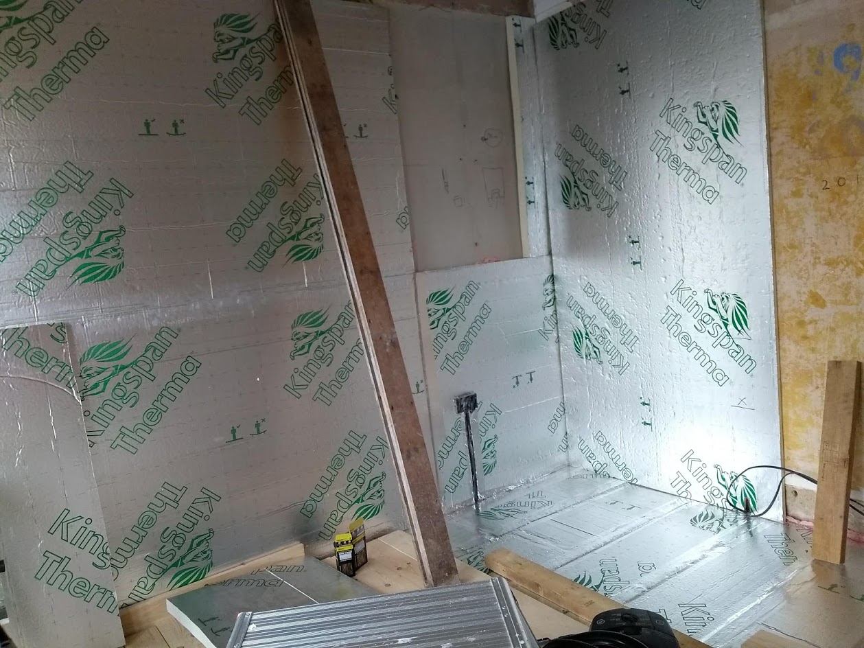

Well, I am in the process of insulating solid walls and suspended wooden floor. 50mm kingspan (or similar) glued onto the walls and put between floor joists makes a huge difference, and will also reduce (hopefully remove) all damp mould problems. Means renovating each room (we slept in the dining room for 3 months and now in what will be my son's room) but well worth the hassle if you plan to stay there for a while.
Gas will keep going up in price, insulation once fitted costs nothing.
This photo probably best shows what I've been up to.

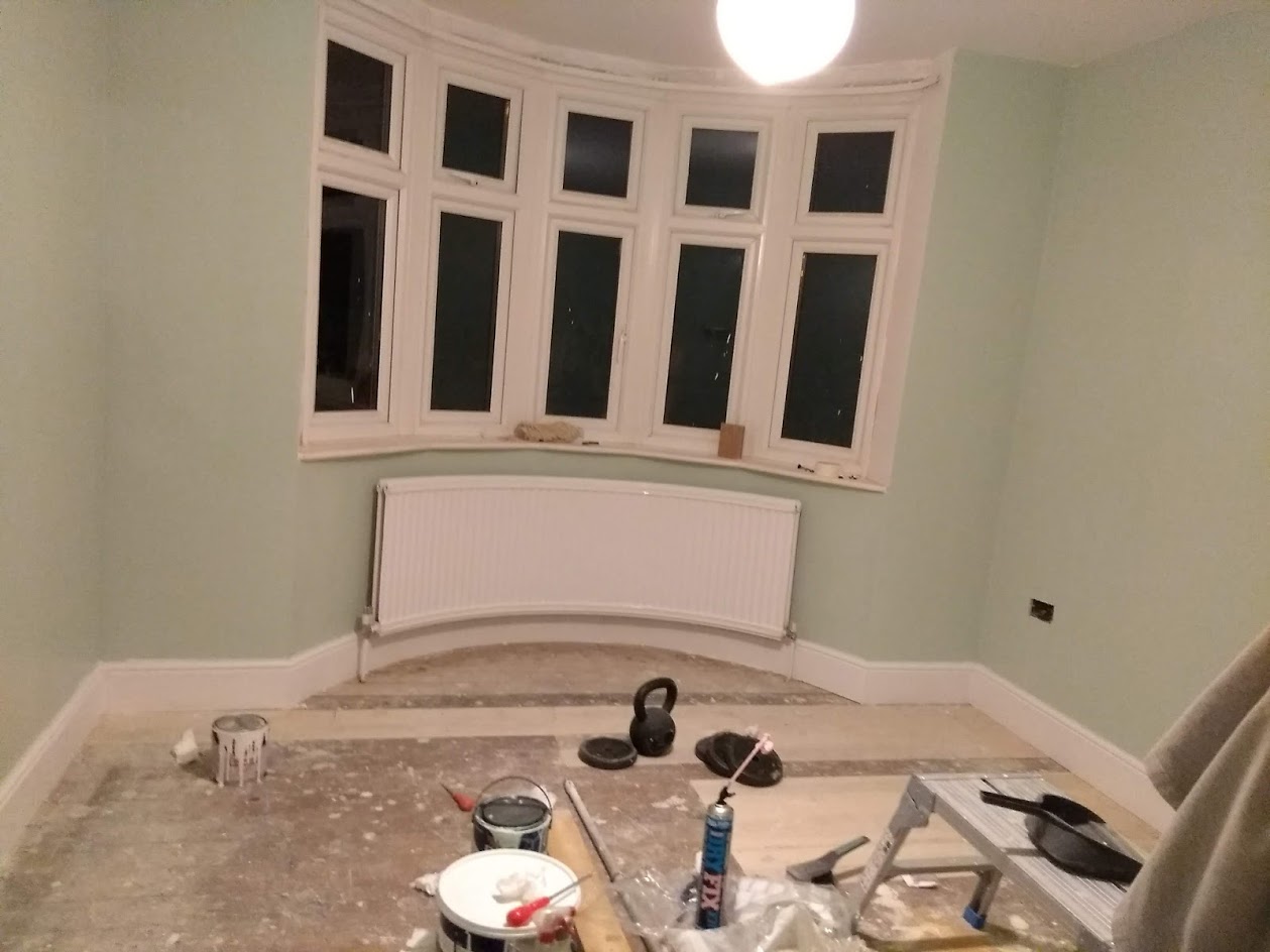

Room now looks like this ... just waiting for the carpet, and electrician to come back

That looks interesting. I have some rooms with solid walls. Did you just attach insulation sheets to original wall? Then what, stick plasterboard straight to insulation or put some timber studs in? How did you do the floor? Do the floorboards just float on the insulation, or is there some timber support for boards?
Thanks for any advice.
Yeah, insulation stuck to wall with Everbuild pinkgrip foam (lots of). Then seals taped with insulation tape. Then plasterboard stuck over the top with pinkgrip.
For floor, just put battens 50mm down and layed 50mm kingspan over the top. All taped up again.
