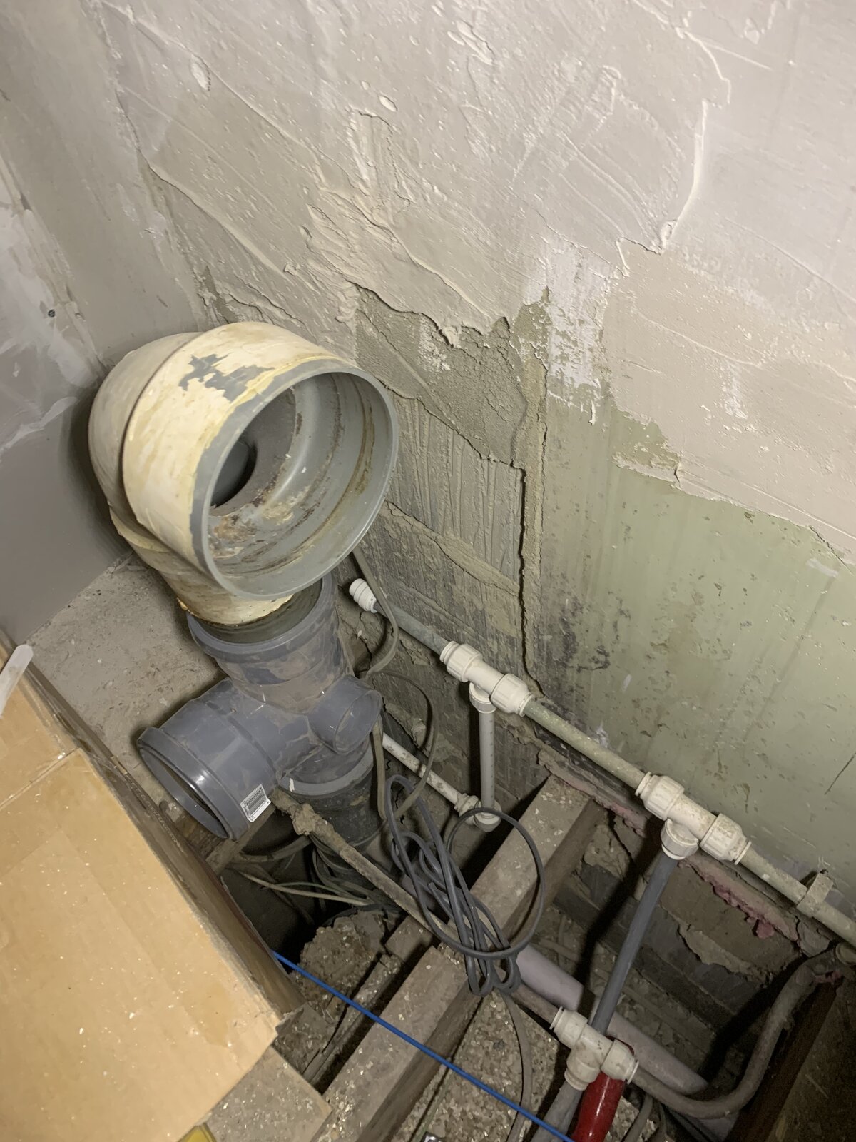

Hi all,
Can I put an air admittance valve on a 90 degree bend on my 110mm pipe.
Will have 0.5m straight run coming out of the 90degree then an air admittance valve.
No.
But with an A1 valve (floplast) you can fit it 200mm above the branch of the tee, in a vertical orientation.
