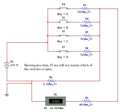

I would guess on neutral earth rather than line earth fault. As more current is drawn the voltage between neutral and earth increases so the fault will not trip when low consumption but will with high consumption and since most items do not switch neutral could be anywhere. It's a get out mega job.

Just discovered something else.
Starting with all of circuits off apart from the air-care, shower and downstairs ring main. I started to turn some circuits on as I did previously. Now I've found that it's tripping with either the upstairs or downstairs lighting, it's probably easier to display the combinations that work in a list.
Note: This is with all other circuits on also.

http://media.diynot.com/76000_75698_3755_93754854_thumb.jpg
Image These two pictures show how with a leakage to earth there all the time the current draw can effect if over or under 30 ma is drawn. The only way to find which circuit has the neutral earth fault is to use a insulation tester switching each circuit on and off will produce the same effect as the neutral is not switched. Hope this shows you the problem. Also hope it works as first time I have tried to upload any pictures Well slight fault the first one with all switches closed should have shown over 30 ma I must have forgot to run multi sim before copying image sorry.
Eric
