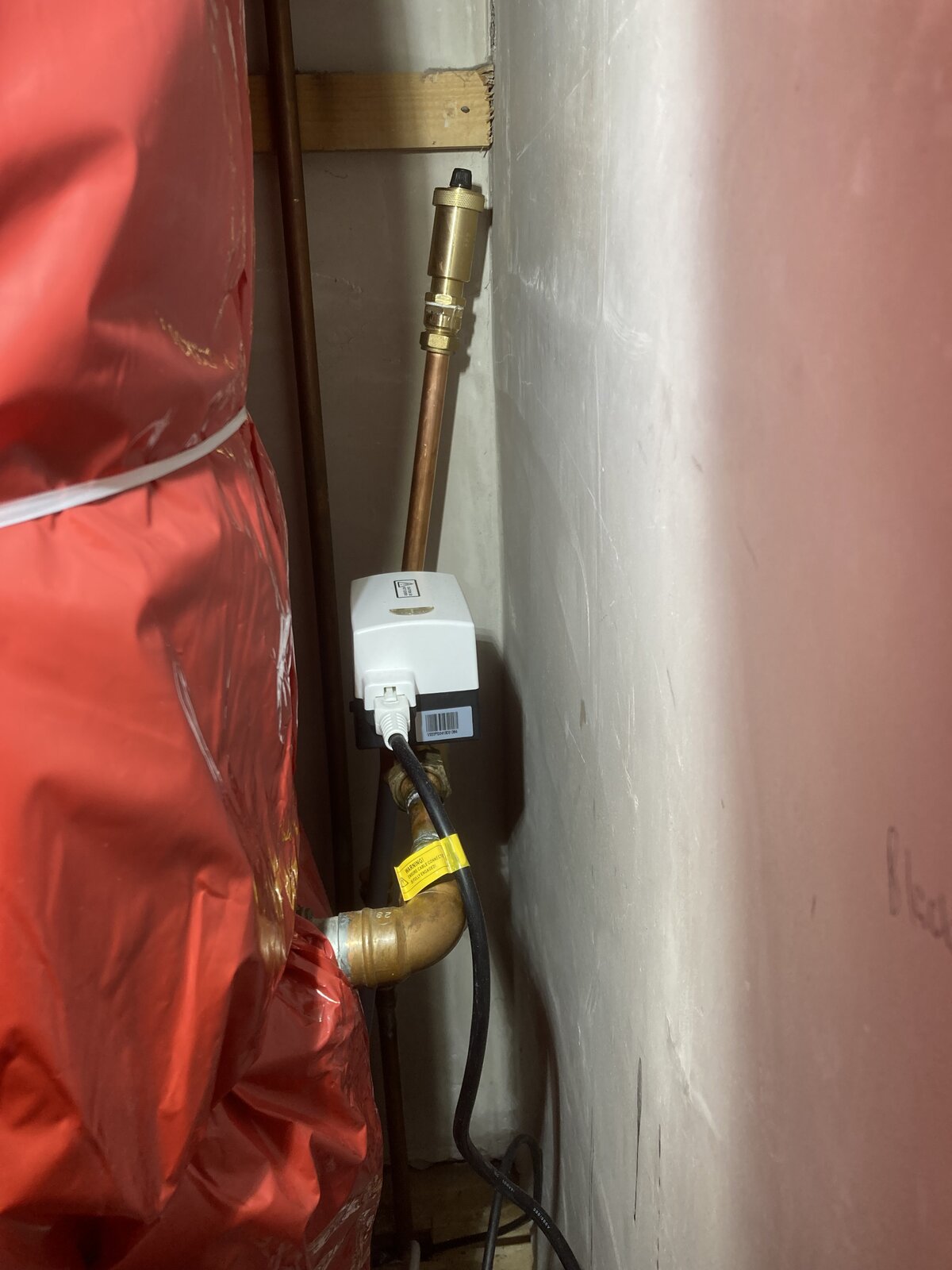

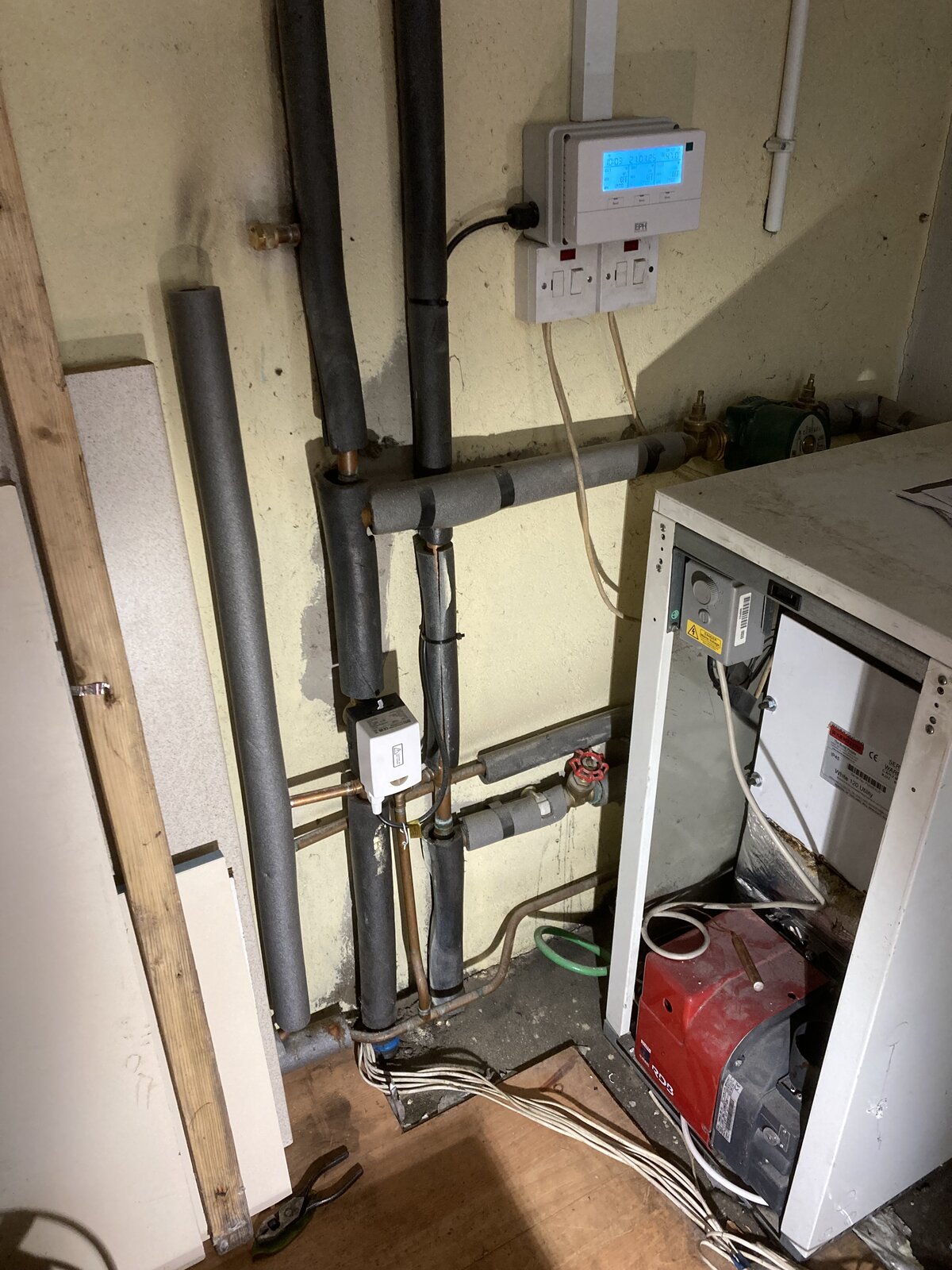

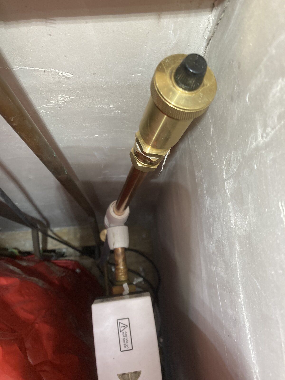

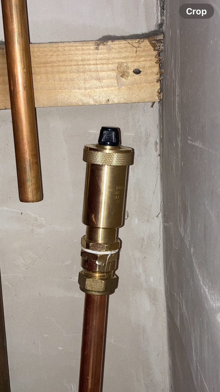

I had a power flush and some zones added to my gravity fed CH system - I later discovered they had disconnected the vent pipe and added the below valve, any idea why? I’ve had to bleed the radiators a few times since they left.
I also need to replace a faulty TRV and was planning to just bung the system but not sure if that would work in this set up?

What you may have (now) is a combined vent and cold feed, in effect no vent, allowed only (by regs, I think) if the cold feed is 22mm or more with no isolation valve(s), It does work but generally a pain when refilling to get rid of the air.
Thats probably a manual bottle vent on the "vent" pipe now.
You may have been getting vent pump over with the old system, ask them why it was changed.
In the last picture the cold feed is the 15mm pipe to the left of the new air valve - it connects to the coil feed at the bottom of the cylinder. The air valve and zone valve is connected to the coil feed coming out in the middle.
I thought all pipe and connections within 2m of the boiler needed to be soldered copper, looks like you have a push-fit and a compression joint too..
