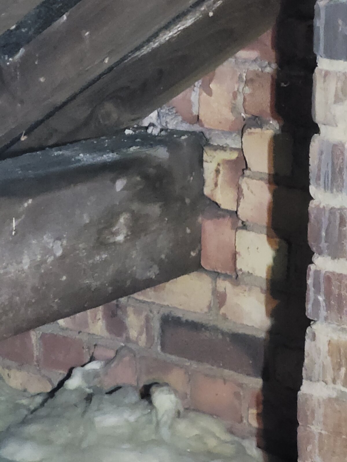

This is our beam in our attic which looks OK to me...no damp smell or musty smell, no salting on the bricks, which if it had been allowing water in long enough for it to seep down to next door I would think there would be greater damage.
Also the flashing that is worn is on our side of chimney and the stack seems to be more on our side of roof than theirs.
I agree that they are looking to blame us somehow.
Anyway I am doing what I am legally obliged to do and if they still have a problem I think the onus is on them to get a surveyor in .Thanks .
