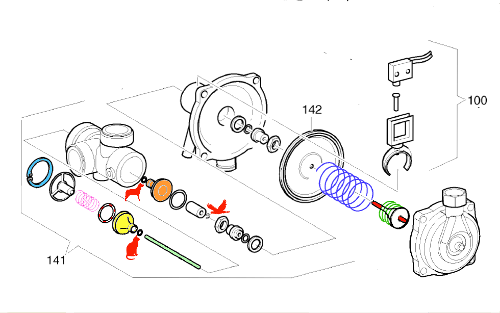

The diaphragm part has a spring which hoilds it in heating mode, running water past the diaphragm has to force the steel pin back using the diapragm against a strong spring. This allows a small join between this section's pin and the other section's pin to line up with the flow switch protrusion so instructing the boiler that the hydrolic conditions are set and the boiler fires for hot water.
However the other section is not pulled across by the diapragm as it's pin is not connected to the water section pin, it is just meant to follow it. If it doesn't followyou are non the wiser because the absense of it still allows the microswitch to sink deeper and so fire the boiler. The mnotive force to move this pin and more importantly the two half cones which duct the water path is another spring at the end of that part. So it is at rest in the heating position and must be forced into the hot water position by a spring. Dirty system water and maybve age of this spring conspire together and the critter gets stuck, in the first place partially but eventually alltogether.
If you split the diverter valve in the middle using an allen key on the two grubscrews in the neck you can get the pin out with one of the cone shaped bits in toe. clean the housing inside the pin and renew the o ring on the cone piece. Though it is the other cone piece which is causing the problem, cleaning and lubricating with silicon grease the pin in your hand might be sufficient to fix things. Your problem is the second half which you haven't got at but the only place it gets stuck is where it slides on this pin. If you want to remove it you have to go into the other end with circlip pliers, catch all the bits as they spring out like zeberdee. Clean and lubricate, new o ring. The critical o ring is the small one which interfaces with the pin, the large one is just there as a seat to seal against a large hole, if you didn't change it you wouldn't notice. Your problem is the lack of movement along the pin under spring power alone.
In all honesty just doing the pin and the first cone piece would in 99% of cases be all that's needed.

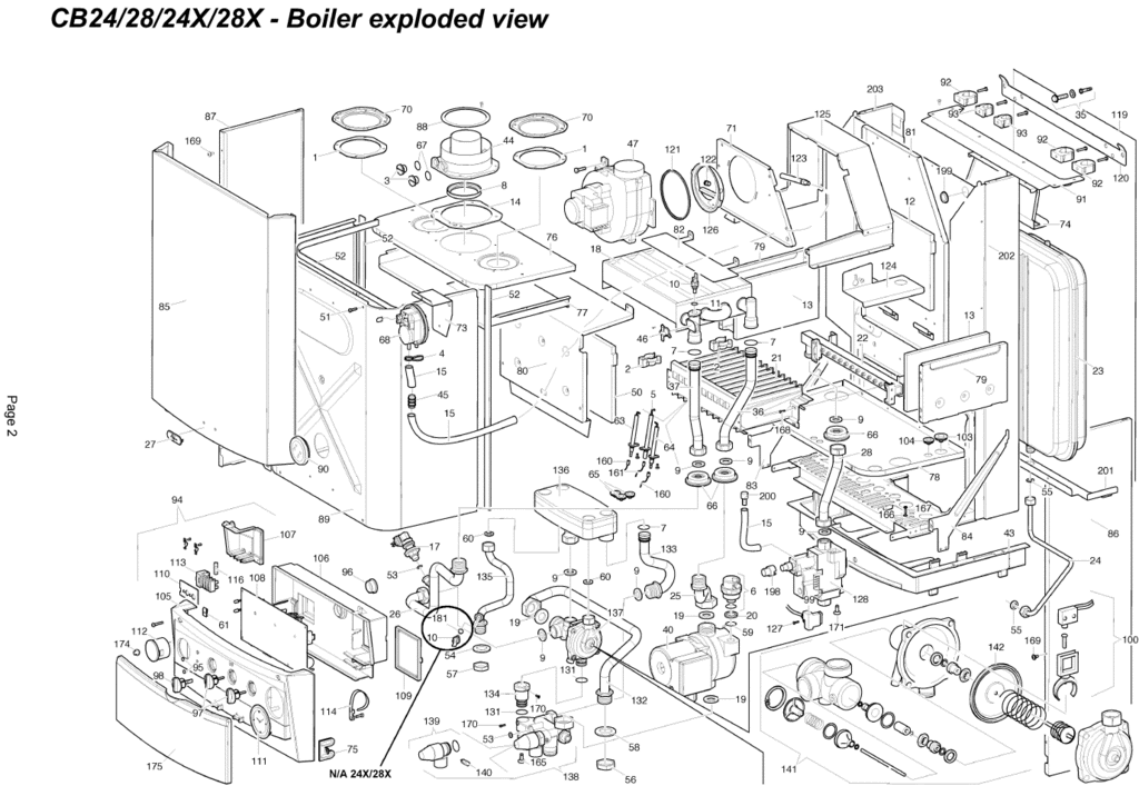

Right then down to business, I've managed to salvage an old exploded diagram of the CB24 boiler, which is complicated but it does help.
Can someone tell me if I have this right in my head before I start work?

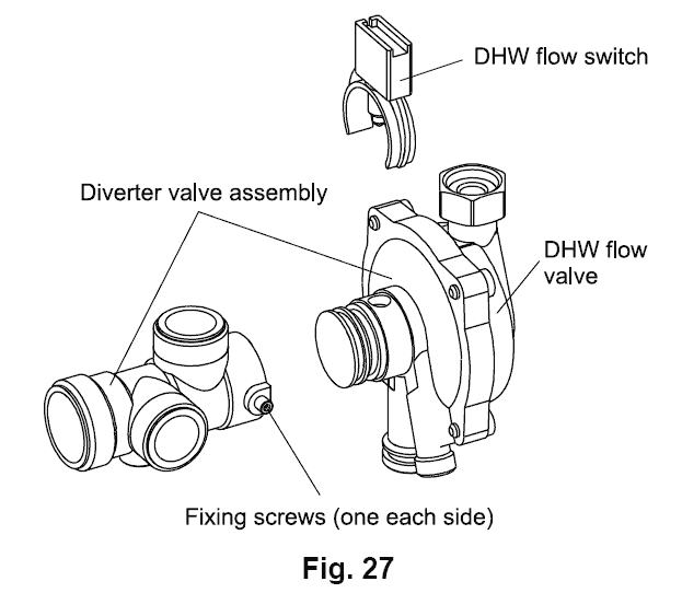

1 Turn off water supply, drain pressure off using valve on front of boiler (that's what I did when replacing the thermistors previously)
2 Remove the two grub screws located at the front and rear with allen key
3 Unbolt each of the pipes that are connected to that section of the valve, one to the front, one that goes up to the heat exchanger and the one on the end of the valve (left when looking directly at the boiler)
4 Remove the pin and then clean and grease accordingly
5 The reassemble in reverse order?
6 Turn on water supply, re-pressurize system with filling loop
Is this right or have I missed anything out / misunderstood ?

Eccoboy - you need the manual, which I believe is on the Alpha site. Squeek if not.
Paul - something of a master opus. Part numbers for the seal sets would be handy.
I'm puzzled exactly where the awkward no 1 phillips screw is - I must have had it easy because I don't remember it. Does it show on the exploded parts diagram?
Couple of pics which might be handy: (click pic and resulting pic)

I'm afraid that I don't have the part no. because we just change the diverter valve as Tony says, but Mike in Sales will know. We do have humungous seal kits which fit everything for £27 plus vat. Something like that.
The awkward screw is retaining the o ring sealed push in part at the bottom of the right hand dhw section where it joins the other manifold to the right of it. Can you make sense of that? You get new screws with the water section seal kit (27 as above) The official thing to do if it breaks off is to fit a new manifold aswell (something like £42 plus vat). Invariably you have to hacksaw a flat in it anyway on an older boiler. On my last training day there was an engineer who said he drills it out and taps a new thread for a larger sized grubscrew, but the Alpha in house man said don't do that we as the water pressure could blow the part off and cause a damage claim. For a non Alpha job I'm sure it is a worthwhile solution for someone with engineering abilities.
In all honesty cleaning the pins lubricating with silicon grease, replacing two very small O rings would get it moving again.
