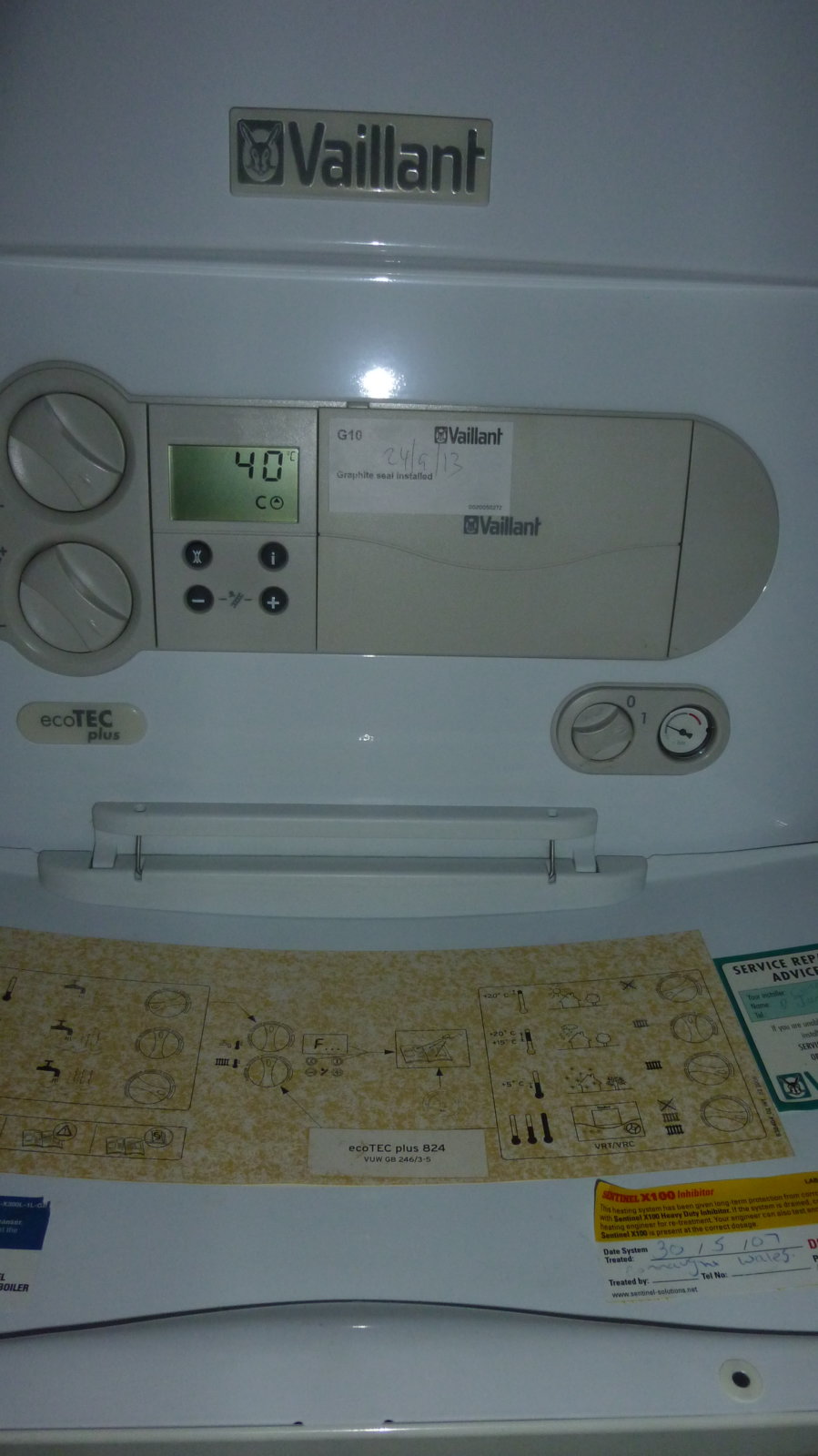

Hi Muggles, thanks for the reply.Its a vaillant ecotec plus boiler,had it installed about 8yrs ago to replace a back boiler and hot water tank system.There is no control or timer for the water, just the heating.
heres a pic of the boiler if it helps..

Your boiler's G10 burner gasket is out of date - they have a maximum 5 year working life. Time for a service
Oh and yes you're right, it is a combi boiler. You'd be surprised how many people get this wrong though!
