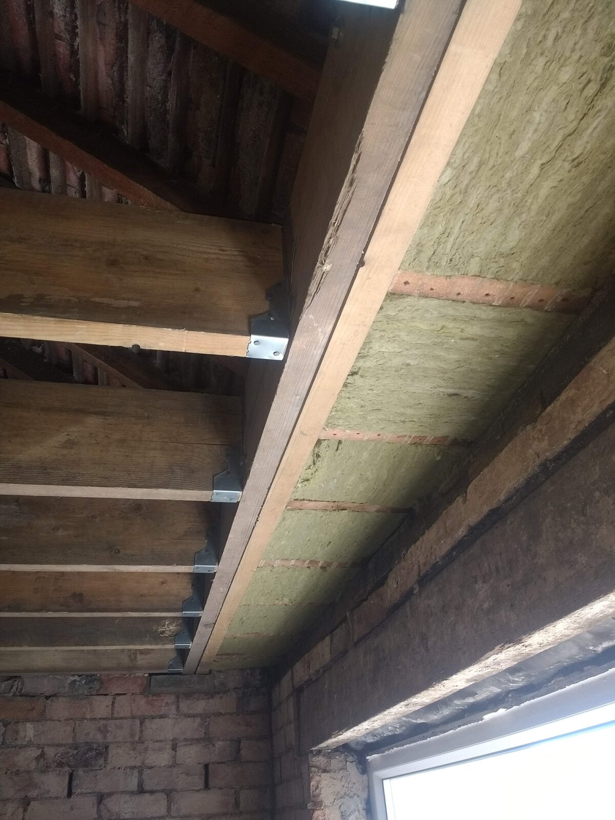

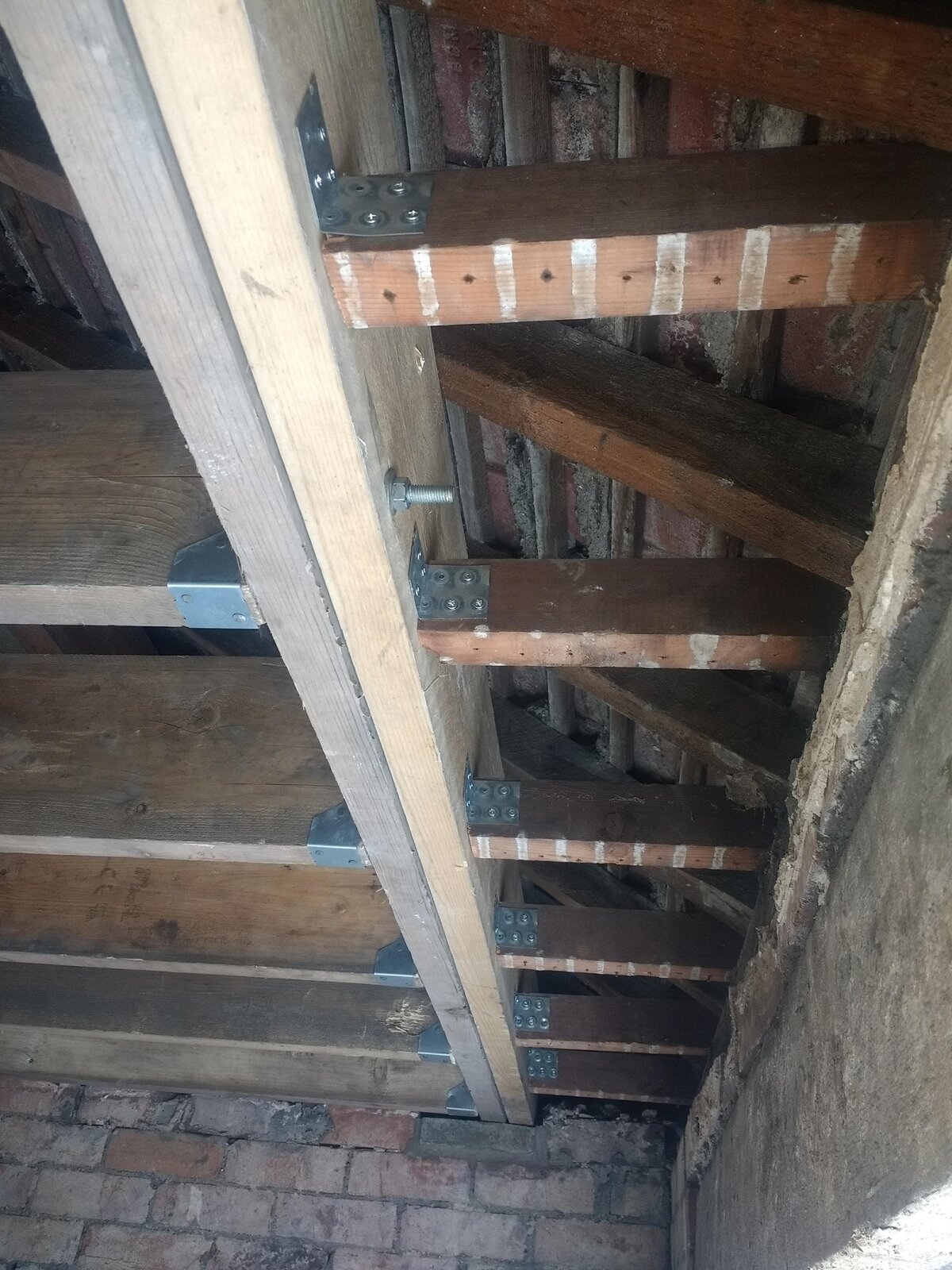

For my money, the best way to do this is to install 2x timber beams of 8x2 bolted together and hung off the party walls from masonry joist hangers, about 750mm in from the eaves. You could install a third beam above the central stud wall if you're concerned about its ability to carry the extra load.
Hang 4x2's off the beam with Jiffy hangers, above the existing joists, this will give you 200mm to fill with mineral wool insulation. Place 50mm or ideally 100mm celotex on top of the joists and then lay your boarding on top - doesn't need to be thick as the celotex will support it - thin plywood or OSB.

Here's mine, slightly different because I had the ceiling down and scrapped the existing joists etc but should give the general idea.
