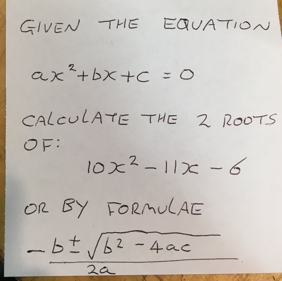

Help on this please
Help on this please
It's difficult to know how to help when the question itself tells you how to do it (there appears to be an unnecessary word "OR" in what is written). I can but presume that you do not really understand what equations are all about, in which case you need to start by reading about that.

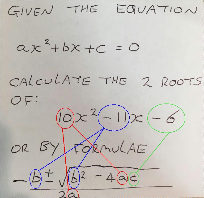

For the equation 10x²-11x-6=0, the roots are 1.5 and -0.4, using the standard formula for the solution of a quadratic (as shown above)
(-(-11) +/- SQR(-11^2 - 4*10*-6))/2*10
(11+/- SQR(121-(-240)) /20
121+240=361
SQR 361=19
11 + 19 = 30
11 - 19 = -8
30/20 = 1.5 ROOT ONE
-8/20 = -0.4 ROOT TWO
QED
