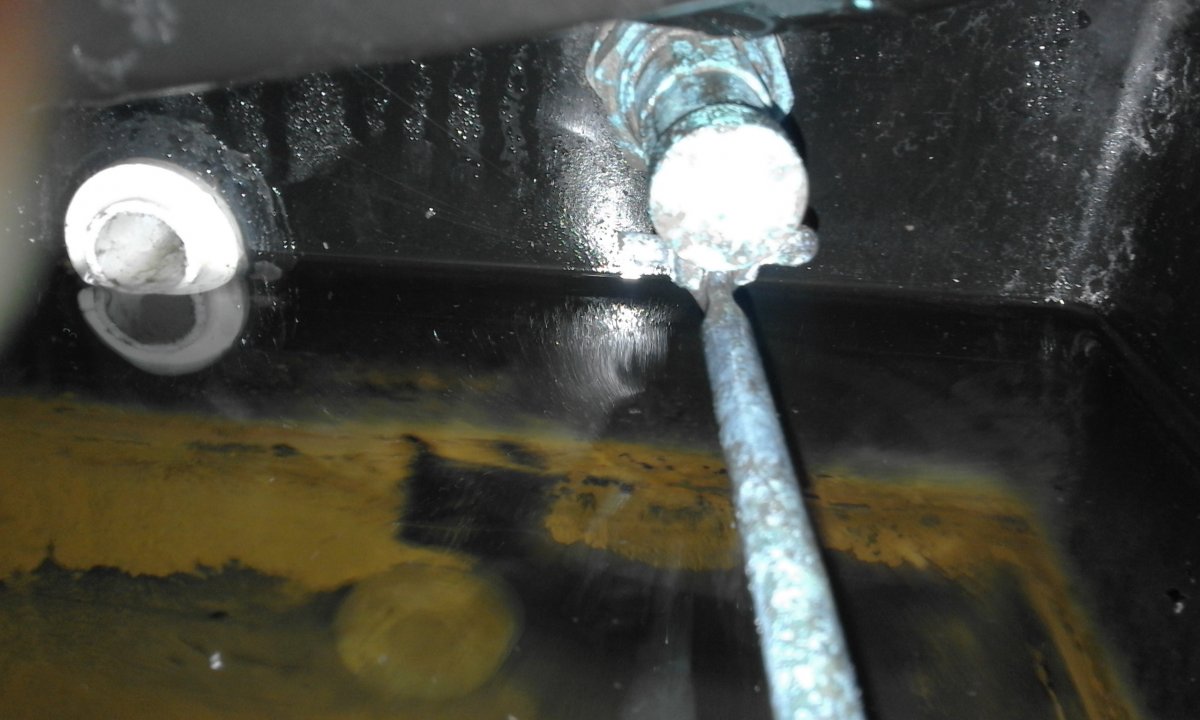

However, I managed to get back in the loft this lunchtime and I've taken a picture of the inside of the F&E tank which is attached.
This is the COLD level of the tank which as you can see is basically at the level of the top drain.
You can see at the back and side of the tank is the brown residue and it's at this level where the tank used to fill to - it must be a good 2 inches above this level.
Does this high level of water have an impact on what happens when the boiler kicks in and hot water is trying to circulate around the system?
For info, where the ballcock arm is connected to the back of the tank, this is where the water flows from when the ballcock is pressed down, so I can imagine this is going to be tricky to fix/replace?

it's very likely that the ballcock is dripping a bit. If you go outside and look at the other end of the overflow pipe you can se how much. This will introduce fresh oxygenated water which will accelerate corrosion, and will also wash away your anti-corrosion chemicals.
The Pegler Prestex Part 2 is a very good valve, you can probably fit it to your existing stem by undoing the big brass nut. It has a better depth adjustment for the float, you only need a couple of inches above the lower F&E pipe entry to the tank.
http://www.screwfix.com/p/pegler-prestex-float-valve-part-2/27627
it may be more expensive in a DIY shed. Inferior valves are available. Fitting a new one is easier and quicker than dismantling and refurbing the old one, but if you like, you can clean up the old one at your leisure and fit a new cone and washer, after swapping. Keep the refurbed one ready to swap back next time.

I've noticed water trickling down the roof of the rear extension into the gutter, it's been dripping constantly for ages, so I assume now that this is the water from the F&E tank?
Apart from the issues you noted above, will the water level be impacting on the circulation of the water in the system, or are they unrelated?
