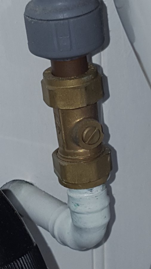

Diallo, yes it does tend to be worse at night, which might make sense if the neighbours were at work all day but it's actually pensioners that live round about me so at least 3 of the other houses are occupied most of the day. The noise has got a fair bit worse since a cold tap in my bathroom stopped working so I'm going to replace this just in case but I suspect it's more a longer term problem than this. I have only recently bought the house, I noticed that the cisterns take ages to fill up, I checked the valves and I noticed that the guy who stayed here before me (who was engineer) had turned the valve slightly to limit the flow (see picture ) so my guess is this problem has being going on for ages and he had tried to limit the flow to limit the noise 20160604_142305.jpg
If this occurs at night, it is worth noting that mains pressure usually increases at night, due to lower demands on the supply! This means that your ball valve fills the tank quicker and shuts of more violently which can cause the water hammer! I think you'll need to get up there and observe it if you are able... Don't go through the ceiling tho ;)
